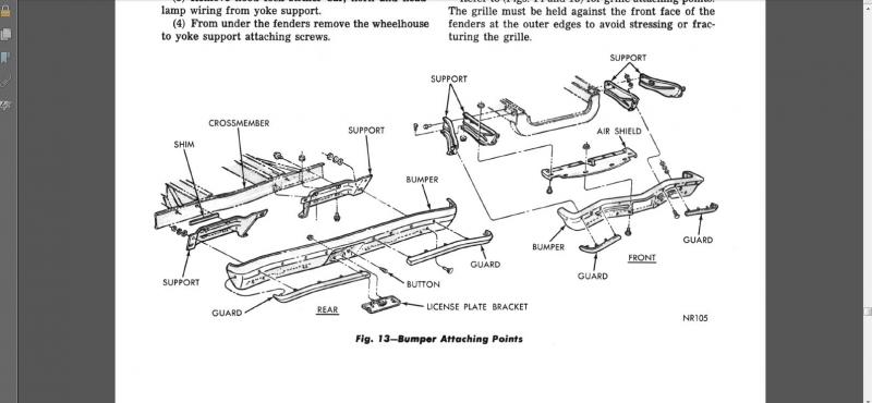

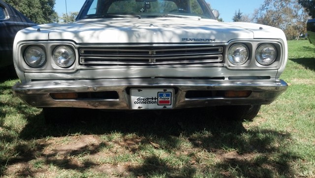

Hey guys..so after a year or so of slowly gathering parts here and there on a budget, I'm ready (I think) to give my 69 a facelift from its current beat up state.

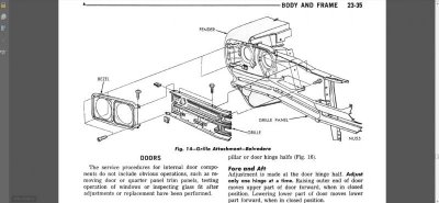

I will be swapping out the front bumper, the bumper filler, and the center grille section. Ive been looking online, but is there some sort of diagram somewhere as to how the assembly is put together?
Beyond that, any tips/pointers on this job? Any tools/other parts Ill need? Won't be doing this for a couple of weeks, but I like to plan ahead and have my bases covered.
No sweat, sorry it isn't bigger. The pages I downloaded were bigger, but FBBO's software must shrink them down. It's from the 1969 Plymouth factory service manual. 69roadrunner.net has it for free download if you sign up to be a member over there (membership is free). Otherwise here's a link to other manuals, downside...no 1969 Plymouth:
