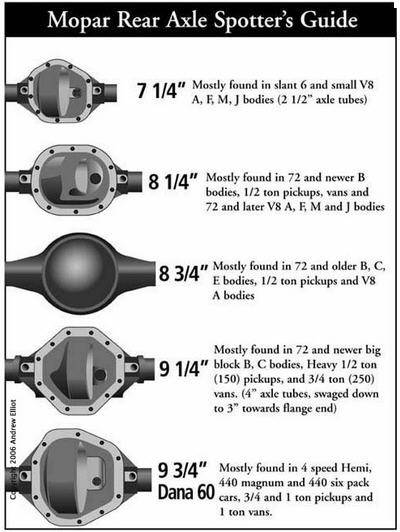

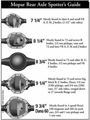

BRakes go with wilwood, they make big disc brake conversion for your vehicle, as far as rearend goes post a picture of the housing or follow this guide
