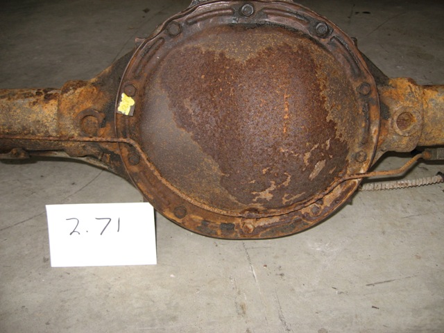

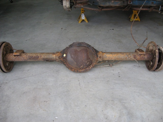

I have a 8-1/4 here are pics for comparison.

Thanks to all of you,just as one more question what can i use to clean the rust off the 8.75 rear end that I have I would say its as rusty as the pic above,thanks alot as always!
Ben , better break out hte sandblaster for that rust.
would a decent palm sander work? and if so what grain paper should i use,any input would help,thanks.
I think I would use a good wire wheel on a 4" grinder before a palm sander.
That was actually gonna be my next question! should I use a brass wire wheel? or does it matter?
