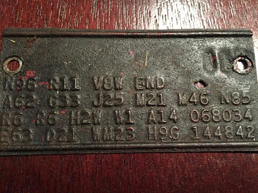

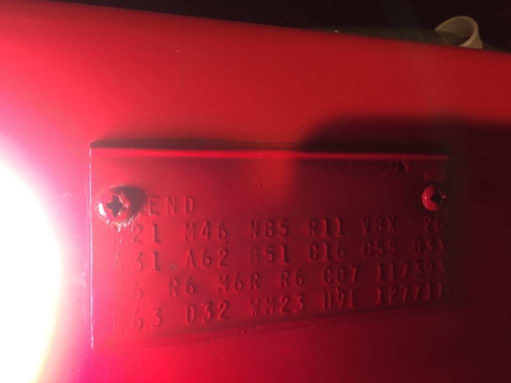

Here is a pick of mine but a different plant. It has both options on it.
The fender tag would have had the N96 option also all the 69 models equipped with the N96
would have had the J25 for three speed wipers. This was a must because the two speed wiper motor would interfere with the air grabber breather.
Agree with the 3 spd wipers, mandatory with N96 hood for clearance reasons you stated. As far as what option codes are listed on the fender tag, I believe that varies at each assembly plant. For instance, mine was built at the Lynch Road plant and it has very few codes listed, althought N96 is on there. Jim's is from the LA plant and texas69bee's is from the St. Louis plant and both of yours are different too.
