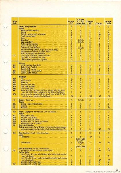

Air conditioning?
Power steering?
Power brakes?
Front discs?

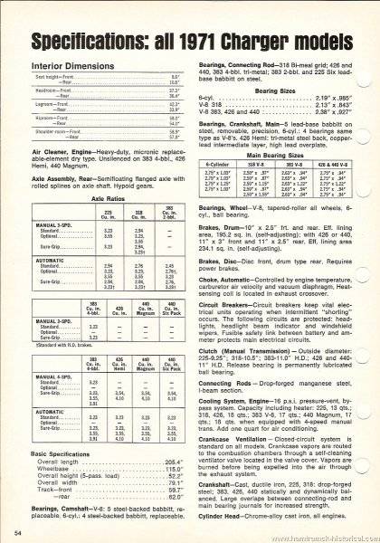

Go to Hamtramck Historical online to see the library of original dealer books to show what you could get
