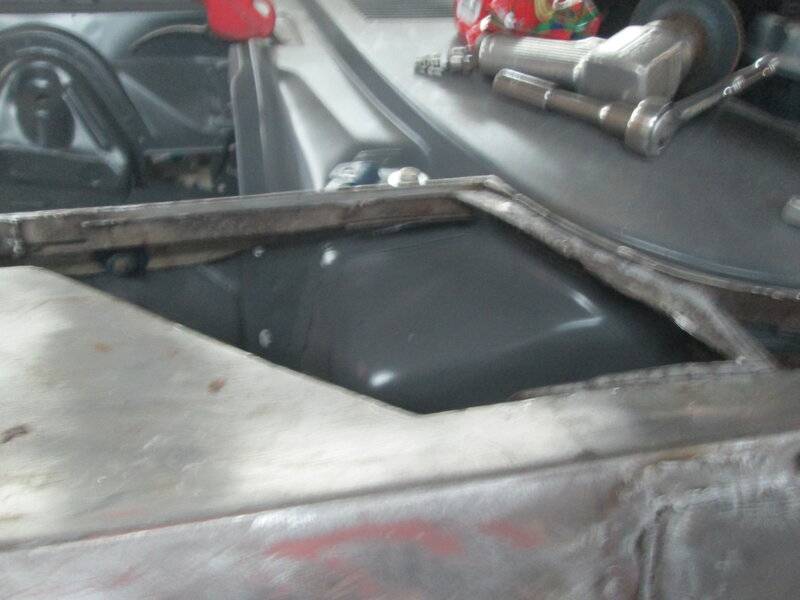

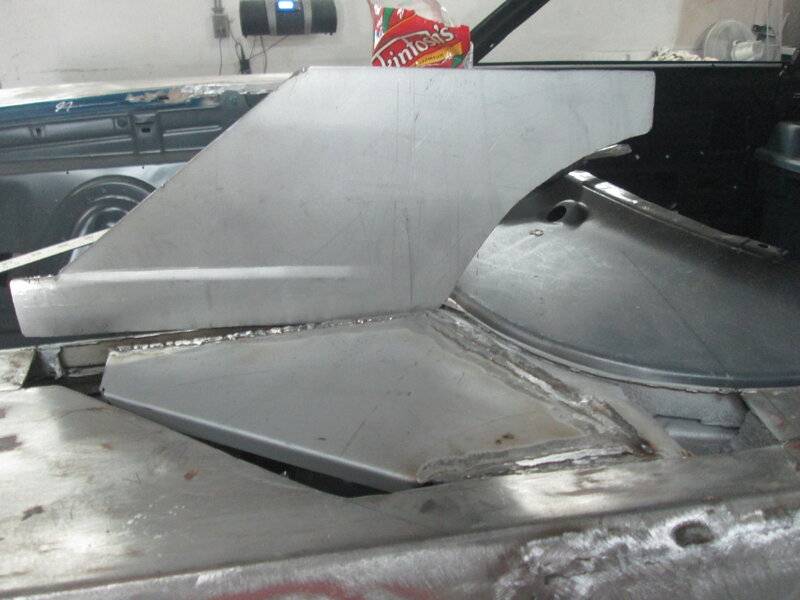

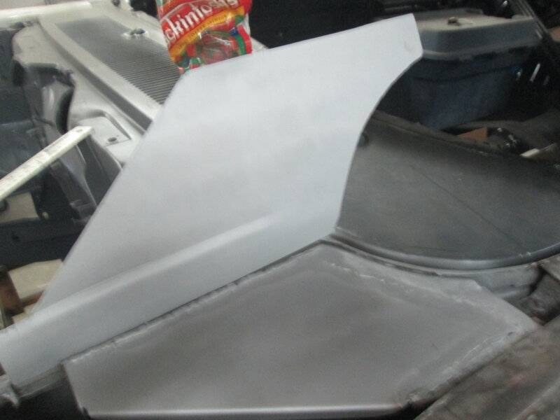

Next are the front fenders. Curious how other guys have positioned or what you have used to hold these so that you can work on them. They are very flexible but also not a flat edge to lay them on to actually work on different parts of them.

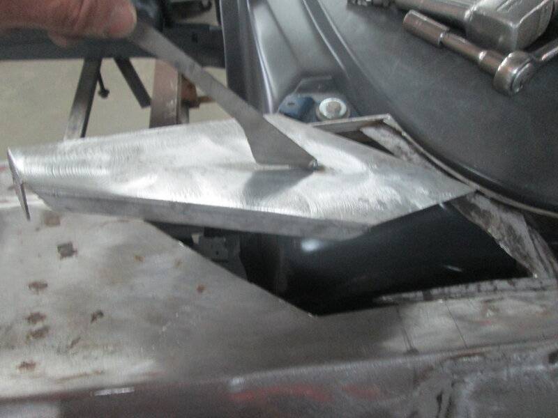

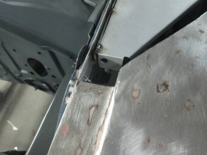

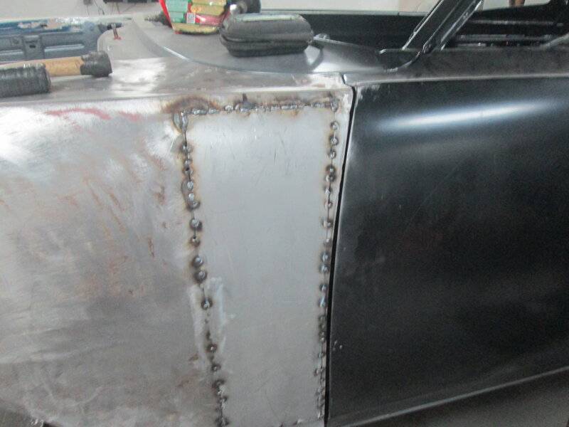

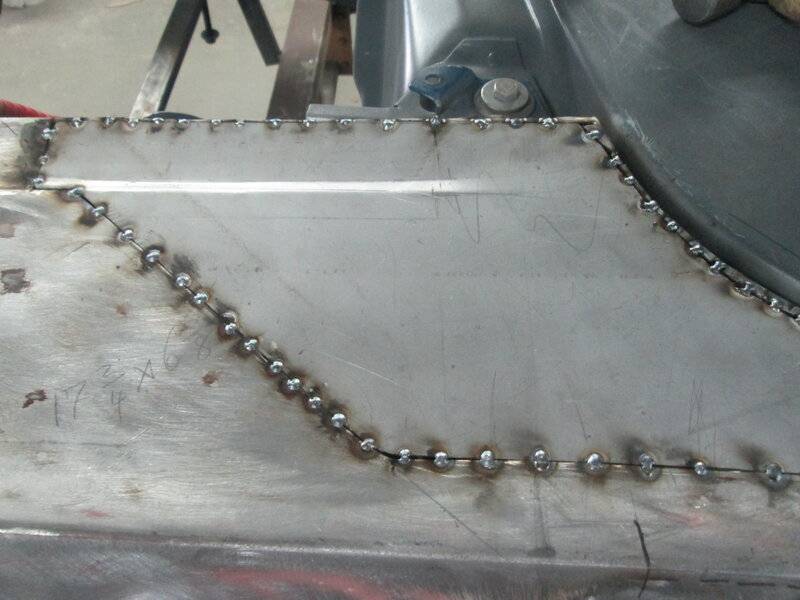

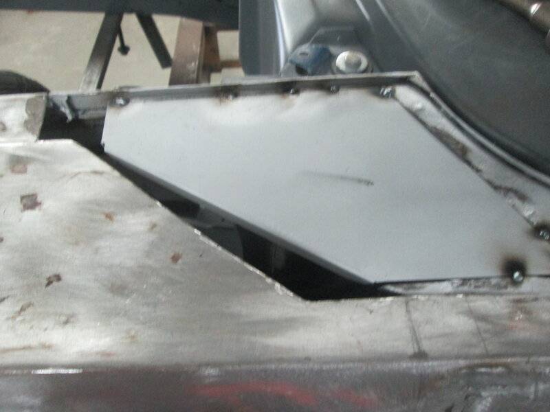

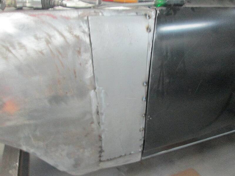

Mount them to the car and get it right the first time, they are not reproduced.
