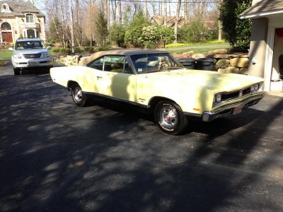

I was looking for a replacement daily driver as my ratty old Camaro (yeah, give me some hell) was on it's last leg when I stumbled across the real deal Super Bee in the local newspaper classified ads and called the guy as soon as I had a chance. The car was a two owner and had spent a long time sitting for reasons unknown but was very original with numbers matching everything. The owner had gotten her running and polished up the original paint as best he could and the second I saw it & person and drove it I was absolutely hooked. I worked out a deal with him and drove it home, about a 45 minute trip down the interstate which you'll see from the pics wasn't a very bright idea.

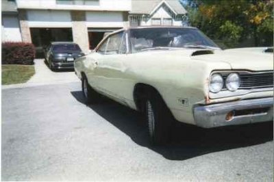

Having 2 projects wasn't going to work so sold the blue Coronet to a Mopar guy in Lebanon, MO that last I heard made it to California. If that sounds familiar to anyone let me know, would like to see if somebody finished it!
So back to the Bee, I was a senior and while girls, drinking beer, and general dumbassery had most of my attention I luckily had a pretty well paying job for a high school kid and a great mom that didn't mind the car taking up the space so I was able to afford to get going on the tear down and moving on bodywork.

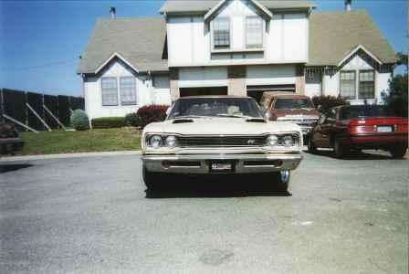

Here's some more pics of when I got her. Even had the factory hubcaps in the trunk! Believe the Cragar's, ugly floormats & the blanket that doubled as a seat cushion we're the only non-factory pieces. Where she wasn't rusty, well even where she was, there were dents, dings & scratches.

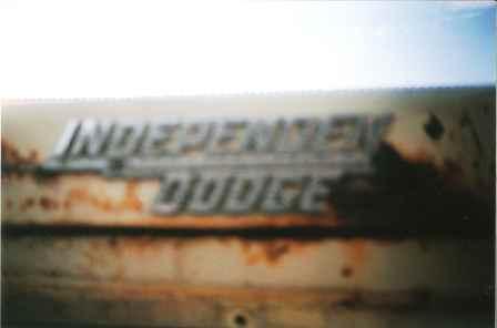

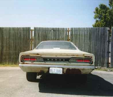

She's been a Kansas City area car since rolling off the STL line. Missing a "CE"
Little bit of vinyl top hanging on for dear life and a glimpse of the rusty mess she was underneath.

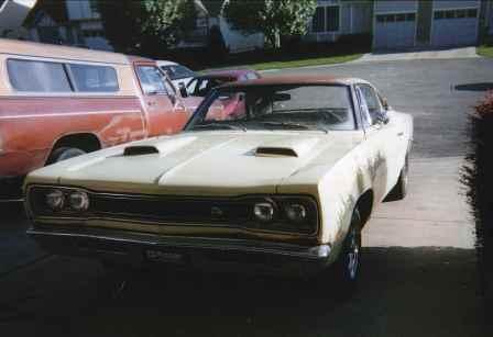

Right after I'd gotten her home, other than the carb leak, bit of oil coming through the PCV there were no leaks!

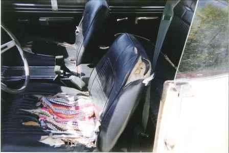

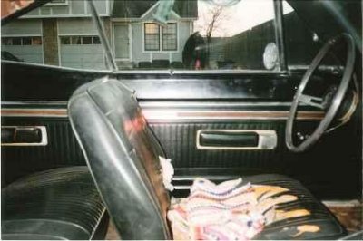

Everything was there but pretty toasted. Door panels are surprisingly in great shape.

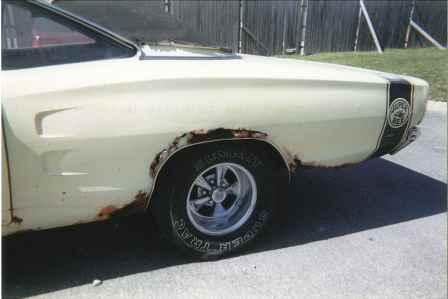

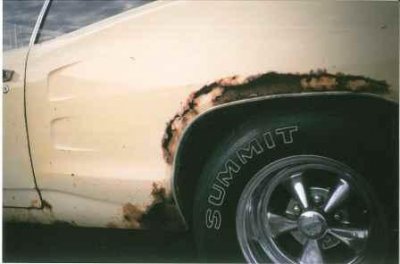

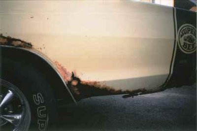

Driver's quarter rust.

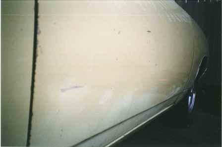

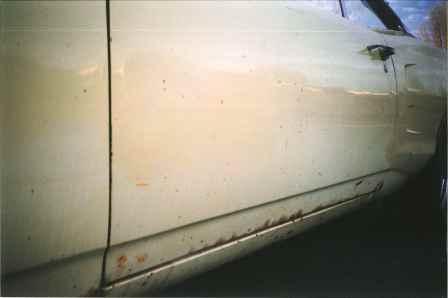

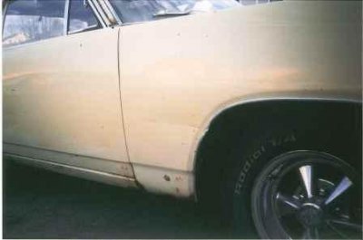

Door was dinged up but the rust was minimal.

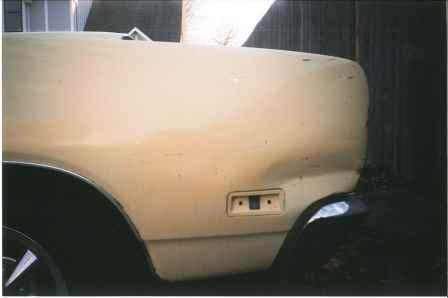

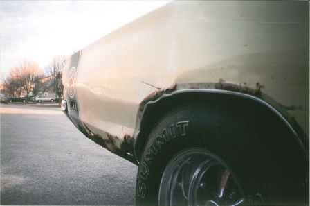

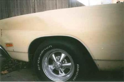

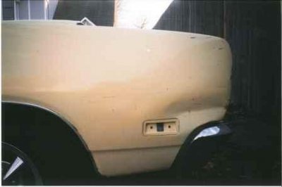

Closer shot of the damage to the fender, if I recall previous owner had accidentally tagged it with a boat trailer.

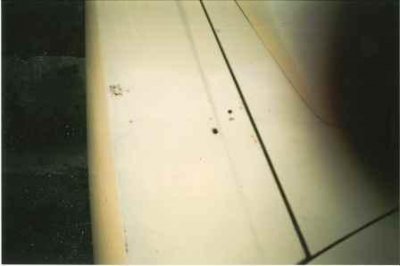

Even rust through on the top of the fender where the splash shield meets it underneath.

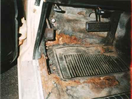

Had the Fred Flinstone feature in case you ran it out of gas. Was an interesting experience having the wind coming up through the hole driving it and had to be very careful where I had my left foot! The carpet remnants and rubber Road Runner floor mat were all that sort of blocked the elements.

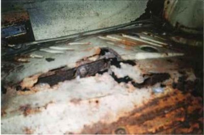

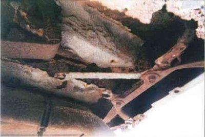

This is a shot from the driver's rear, the gas tank on the right & exhaust pipe on the lower left. That rusty gap in the top left is where the framerail is supposed to be. :eusa_think:

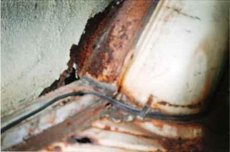

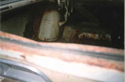

Driver side trunk, salt from below and water leak from above made a real mess of it.

Front end of the quarter, somehow the rockers survived.

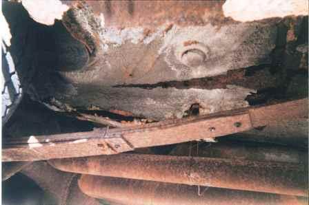

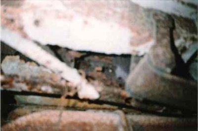

Another view of why I was a dumbass to drive it... really was no frame rail left under it on the driver's side.

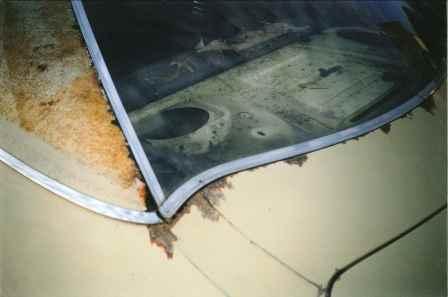

Rear window corners were bad, other than one small spot on the top passenger corner the channels were surprisingly solid.

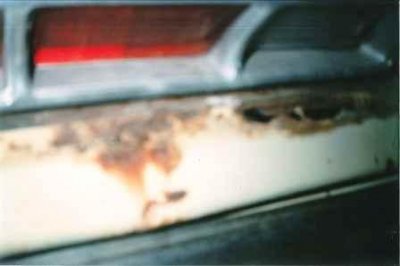

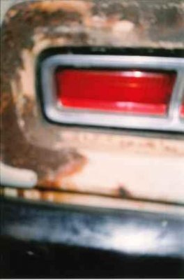

Was worried about the tail light corner areas where that pot metal end piece attaches but while pitted it wasn't rusted through.

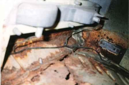

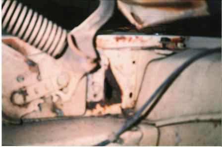

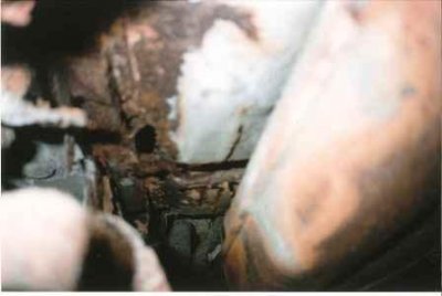

This is the scary one. Mentioned earlier I drove the car home, was doing about 70 down the interstate with this somehow holding over every bump. Once I got it into the body shop the guy told me about a week after I'd brought it in he went out and the car was sitting really low on that corner. The rest of the rail had given out and the spring was sticking up in the trunk :icon_eek:

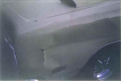

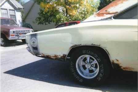

These big old L60's just barely fit but the mess that driver's side frame rail was in the car had effectively lowered itself and was digging the top of the wheel well into the sidewall over the smallest bumps. When I test drove the car the first time we took it up an entrance ramp and while by the smell I thought it was burning rubber the whole way up, I think a lot of it was the tire being carved.

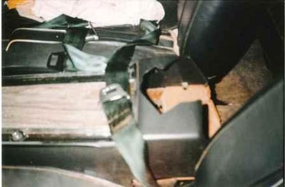

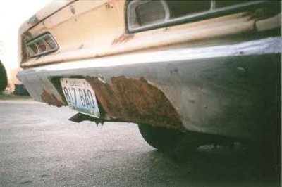

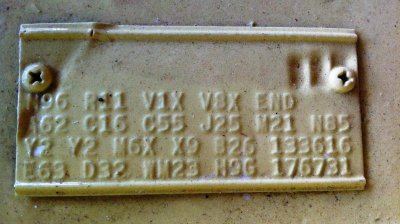

Should have posted this first but the Bee did have the original fender tag & the build sheet was under the rear seat springs in really good shape!
Thanks to Stockmopar.com for the decoding tool. Was built on the same day OJ Simpson won the Heisman :angry7:
Code Description
E63 383-4 Barrel
D32 H-D A-727 TorqueFlite Trans
WM23
W = Dodge Coronet / Charger
M = Medium
23 = 2 Door Hardtop
H9G
H = 383 330HP OR 335HP 1-4BBL 8 CYL
9 = 1969
G = St. Louis, MO, USA
176731 Sequence Number '176731'
Y2 Paint Code: Sunrise Yellow
M6X
Trim Grade/Style/Color
M = Medium
6 = Vinyl Bucket Seats
X = Black
X9 Upper Door Frame: Unknown At This Time
B26 Date Built: 11 / 26 / 1968
133616 Order Number: 133616
C16 Roof Type OR Color: Console w/ Buckets
C55 Bucket Seats
J25 3 Speed Variable Wipers
M21 Roof Drip Rail Moldings
N85 Tachometer
Y2 Unknown At This Time
A62 Rallye Instrument Cluster
N96 Fresh Air Hood
R11 Music Master Radio AM
V1X Full Vinyl Top - Black
V8X Transverse Stripe - Black
END End of Codes

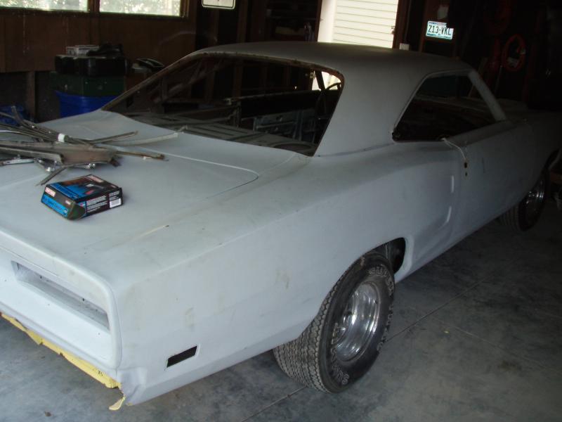

This part I don't like. I have absolutely no photos of the tear down and panel replacement...was away at school while it was happening and didn't ask the guy to take any.
Was an old guy by the name of Van Don'trememberhislastname down off of 12th & Quindaro Blvd in Kansas City, KS which if you're not familiar with Kansas City is one of the most rough and tumble parts of the city. Stopped in about once a month to give him payments and was followed off the highway and to his house twice by some guys that didn't appear to want to be my friend and when a guy who's lived there his entire life yells at you to hurry up and get inside, you listen. :icon_eek:
Anyway, he did a decent though not perfect job on it and for the work involved and time spent I feel like it was money well spent. Biggest gripe I had is while he pulled the rear window and fixed the lower corners, did leave in the old trim clips and there were a couple of rust through spots across the top of the rear window he didn't touch but as I think about it, very well could have been on my end coming to the end of the $/hrs work we'd agreed on.

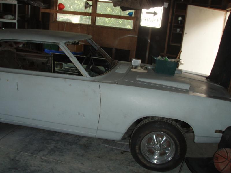

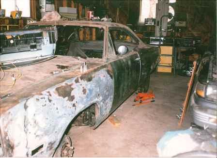

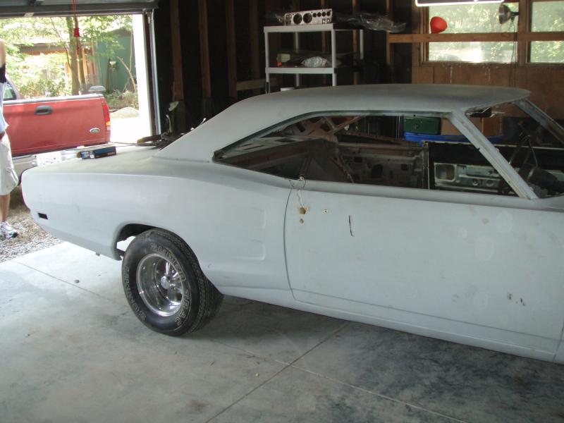

After I got the car back from the first body guy it sat for several months in my Mom's 1 car garage (she gets first dibs on driving it once back together) during my stay at the dorms freshman year.
It was then off to a garage at the house me and a couple of buddies lived in where it served primarily as a coaster for red solo cups and would occasionally fire it up to make certain the neighbors did in fact hate us. I got absolutely nothing done on it that year.
After that wild year was out of my system I had the car at a friends shop for the next 2 years where we did get a bit done here & there and mostly sourced parts as my income could withstand.
So these pics are after all of that time and during my second time around as a college senior when I met my now wife and decided to really get going on it again.
No idea why he painted this area yellow, was afraid issues may be hiding under it but never found anything later on.
During all that time the original 383 had never had come out of it and still ran great after not doing much more than rebuilding the carb the year I bought it. Sadly though, one time when I fired it up to blow the cobwebs out a valve decided to blow out as well, eating a hole in a piston top but luckily only barely scraped a cylinder wall before I shut her down.
While not an ideal situation, it did have what I believe to be 95xxx miles on it with no signs of it ever being apart so probably due for a refresh. I'll keep telling myself that anyway! So shortly after these pics, out came the motor & tranny which is a whole different story.

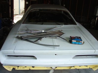

Quarters were replaced, trunk floor & extensions, driver's side front floor and a patch on the passenger side. He reworked the front the front fenders but as I found out later missed some soft spots behind the headlight bucket areas.
