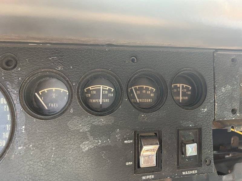

Last owner could of installed gauges wrong,post a pic . Yes you can switch the wire . Should look like this.
Check the color codes and location of said in the bulkhead connector.
Thanks. Yup, did that. Turns out the wires were flipped in the flat plug that runs the Rallye gauges. So I just took a little pick and pushed both out and flipped them. Good to go there. Issue number 742 corrected.
