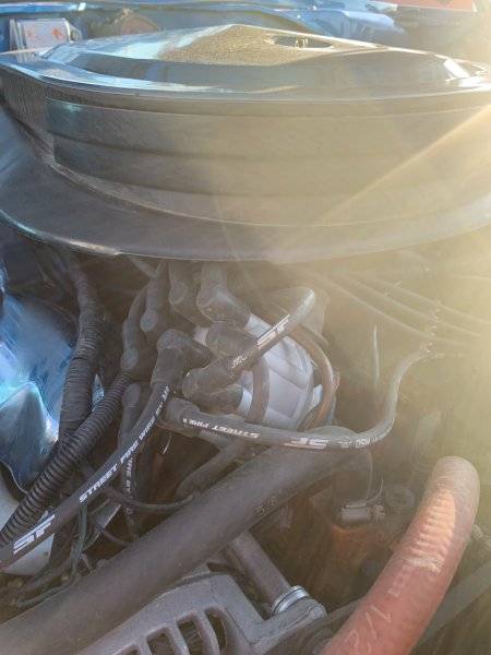

Hope I am not beating a dead horse too bad here.Do the original bases have a notch for the distributor?I have one from a guy that bought his car in 1973 and Swears he never changed bases and it has this notch,no part number or stamping either.
He had the cover chromed in the 80s but nothing done to base 2nd owner car
My guess the lip was rolled out so it did not cut into the plug wires.
That is factory. Yes it so it doesn’t abrade the spark plug wires. It’s on all of the fwctpry bases.

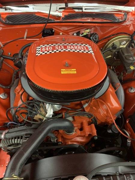

The only 340-6 base was AAR TA and they are bigger diameter to seal to the hood. And they have the distributor in the rear. So why would it have anything on the right front corner?
Now back to 440-6 bases it has nothing to do with the shield or not.

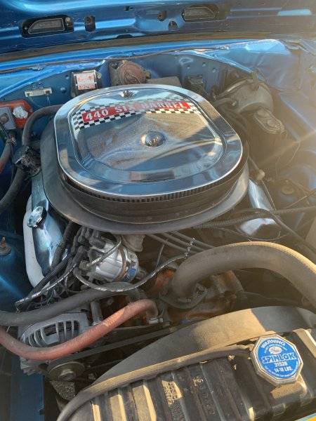

This is what I had and from what I read it was a repop so thanks for the answers he is going to swap with me
Cleaned up and installed, will need to be touched up to be perfect but at least it’s correct

Is that a two speed wiper motor you have on there?
Yes it’s an E body or 71 and up B body and a big air cleaner will clear a 2 speed.
But will not clear on a 66-70 b body.
