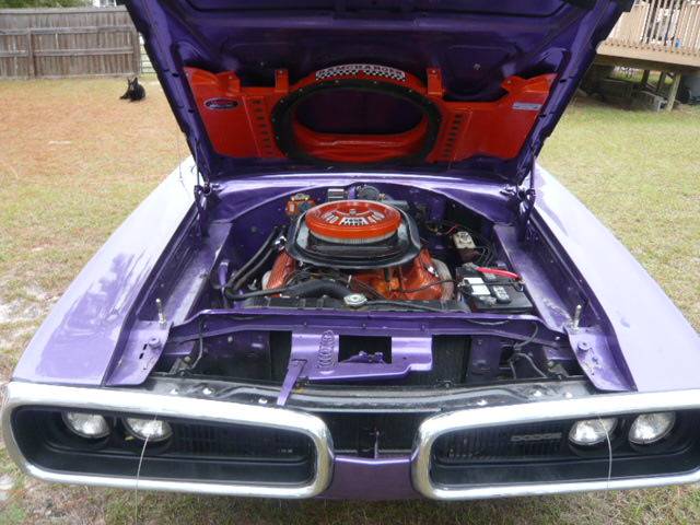

I am considering adding it on, as I have the hood and ductwork. On looking at OEM and aftermarket, they say the bases are for a specific motor, but no mention of the different heights of the air cleaner base. I am using a stock carb as well.

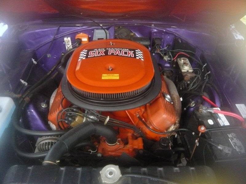

How to tell 340, 383, 400 and 440 4-barrel Ramcharger and Air Grabber air cleaners apart.
The 383 and 400 engines are shorter than the 340 and 440 engines so the air cleaner base needs to be taller to seal to the hood. The 340 and 440 ones are the same height. You can measure them a couple ways to determine which one you have.

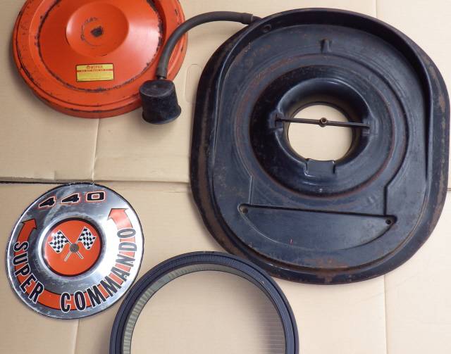

1969
Thanks to Tim Bernardin for the following images showing the difference between two 1969 air cleaners. Click on the images for larger views.
Click here for larger view.
