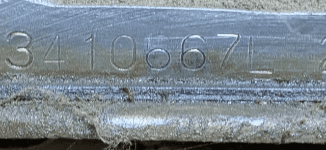

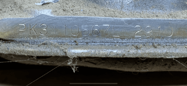

Hello and good day to all of us! So i have (I believe) is a hemi trans, but when looking at the numbers i am confused as to what i see, so i ask for your opinion. I am hard pressed to tell if this is a "6" or an "o" over stamped or used as a "spacer/correction".
Since I'm not a numbers guy, just pull the front pump and see if it has the wide front drum. That tells the story, not the number stamping.
Why do you think this is a hemi trans? As said it’s a 1970 383-2bbl case. A 383-2bbl trans doesn’t have the hemi drums and other parts.
You can remove the pan to see if the drum is in there. But it could have been removed at anytime.
Hello all, I do thank you for all your replies and insights and agree that it is a 383 2bbl trans (an acquaintance of my local had that Hemi idea) and that is why I put it out there. I have learned in life that you don't get if you don't ask. Now I can move forward...Thanks for the relief!...Lol. Till next time
