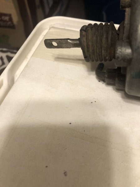

The headlight version also has a different style shaft than the AG version.

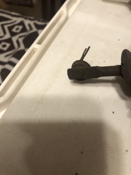

Agreed--I forgot about that. The shaft appears to be the same length & thickness but the end has a hole in it instead of the clevis pin-style end in the shaft of the air grabber actuator. It is the pin that attaches to the mechanism that operates the door open and closed. I simply put a small screw/washer/spacer/nut there and it worked perfectly. You could probably find a clevis pin if you look around.

Here’s the differences between a ‘68 Charger hide-away headlight door vacuum actuator and a ‘70-‘72 Air Grabber & ‘71-‘72 Ramcharger hood vacuum actuator.

3. 3rd pic air grabber pivot pin pressed in
4. 4th pic ‘68 Charger actuator has the same hole, but no pivot pin pressed in.
The connection where the pivot pin would go (in the hood mechanism) needs to pivot freely.
