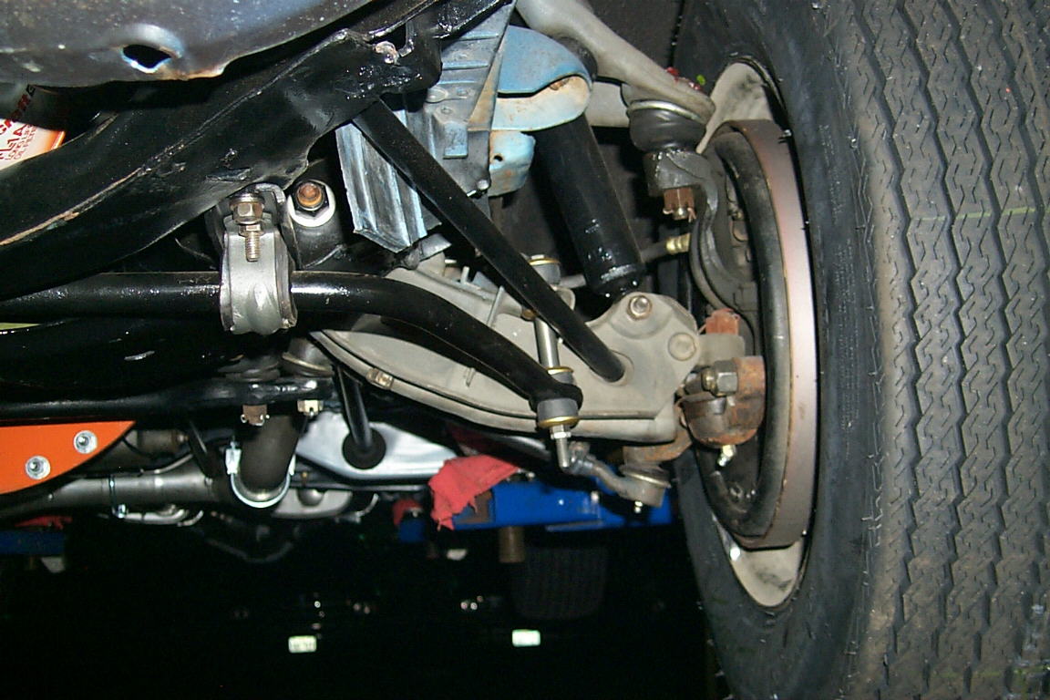

The factory one ran through the K frame and the LCA's had tabs on them to attach the drop links. If your car didn't come with a sway bar, then you would probably need to swap LCA's IF you want a "factory" setup. Otherwise consider an ADDCO setup
