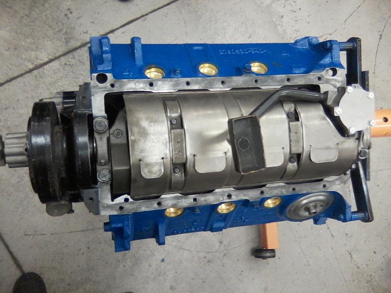

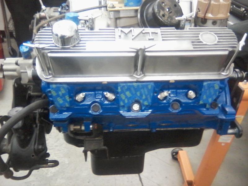

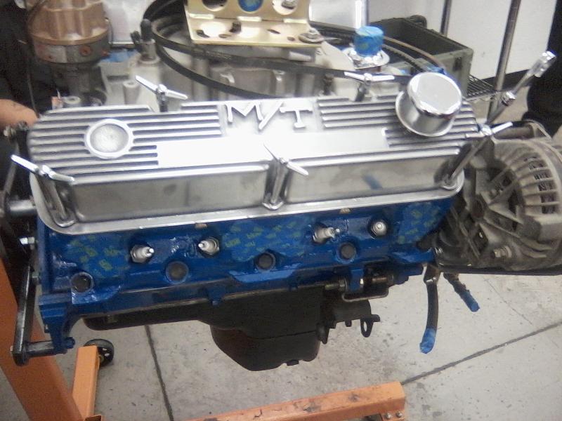

I finally got done rebuilding my first engine!!! She is a 1970 Barracuda engine "J" Block. Tomorrow I"m gong to stab the 727 trans and drop her into a 73 Road Runner. I'm so excited!!! I Sooooo want to hear her crank
Looks like a nice build. Anything special regarding cam, compression, or intake ??????
Just tell us what went into the rebuild! Enquiring minds wanna know!

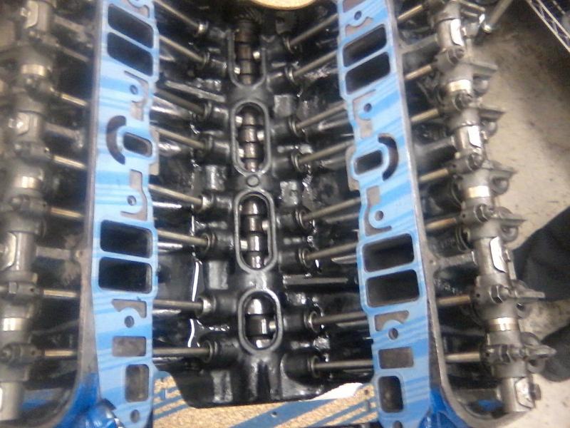

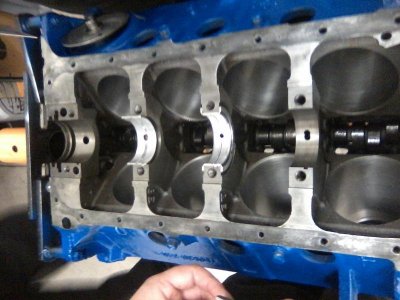

installed edelbrock lifters, timing chain, sealed power rings, main bearings, rod bearings, installed a edelbrock performer plus camshaft, honed the cylinders, and replaced the rocker arms, changed the freeze plugs from steel to brass, painted the valley and exterior.

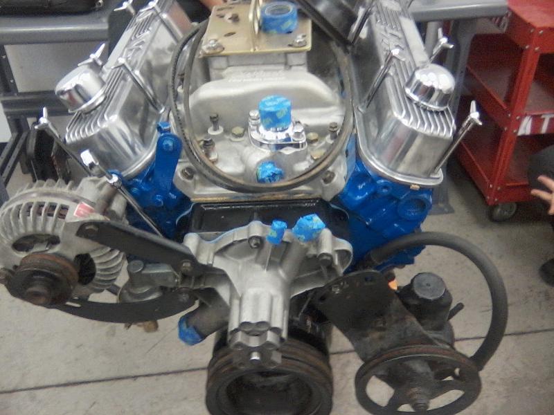

Are you going to paint the brackets, steering pump, pulleys etc before installing in the car? Looks like you are doing a great job. Keep it up and keep us updated, especially when it runs.
no im not going to be able to paint it.... i got to get her running before my ol'lady comes back from deployment...lol
