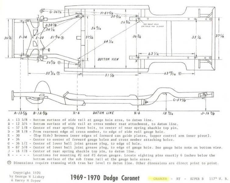

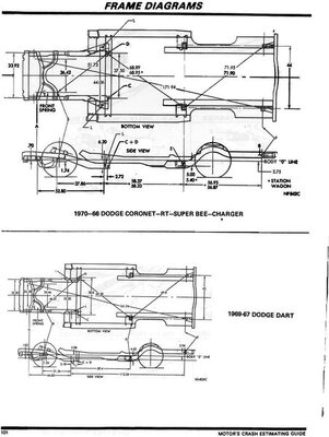

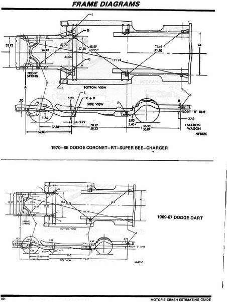

Hi everyone,
Looking for measurements and specifications to ensure my 70 Bee is square. Replacing floor pan, trunk pan and extensions, both quarters, and all metal around lower rear window. I will be bracing the car where necessary. I know my car is not straight because it was in an accident. Any help would be greatly appreciated.
Have a awesome day!
This is the best you are going to do without having another car at your disposal.
I really appreciate your prompt response. This will definitely help me putting the car square. Now, I only need the specs or measurements for sheet metal.
