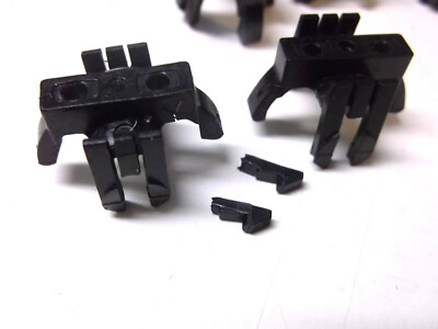

I took a window switch apart once . Most of the tabs broke. Pot metal?
I found this mopar power window switch rebuild service on E-Bay, that looks very interesting.
I personally cannot vouch for him, but he has incredible positive feedback, having done many.
Here is the link if U have any further interest.
Just my $0.02.. :thumbsup:
That's me.
Thanks!
