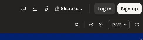

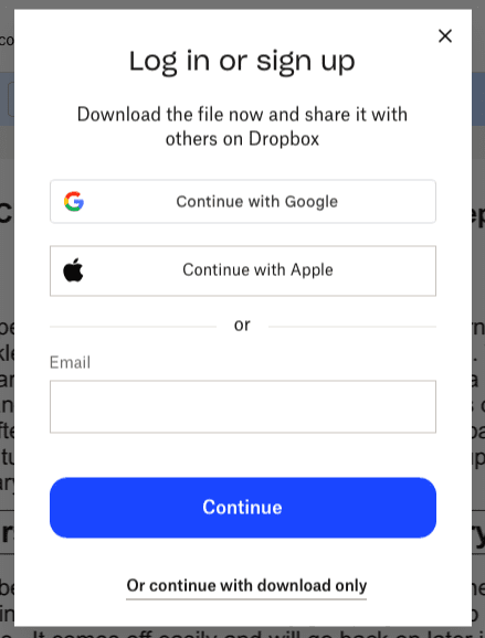

You don't need to sign up or log in to download the PDF, Just click on the down facing arrow as shown , 2 nd character from left at upper corner of the screen. Another pop up window will appear asking for you to log in or sign up. Click at bottom of that second window to where it says "Or continue with download only" It will start the download into your downloads folder on you computer..
