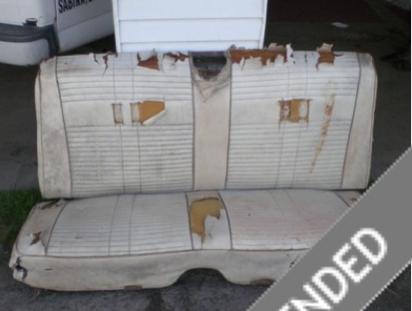

I don't know what it came out of but when I bought it, it was advertised as:
"1968-69-70 REAR BENCH SEAT CORE B-BODY CHARGER SUPER BEE ROADRUNNER GTX"
Here is a picture let see if anyone can figure it out from that!
It looks like 68 deluxe to me....with the decor inserts cut out of it.
