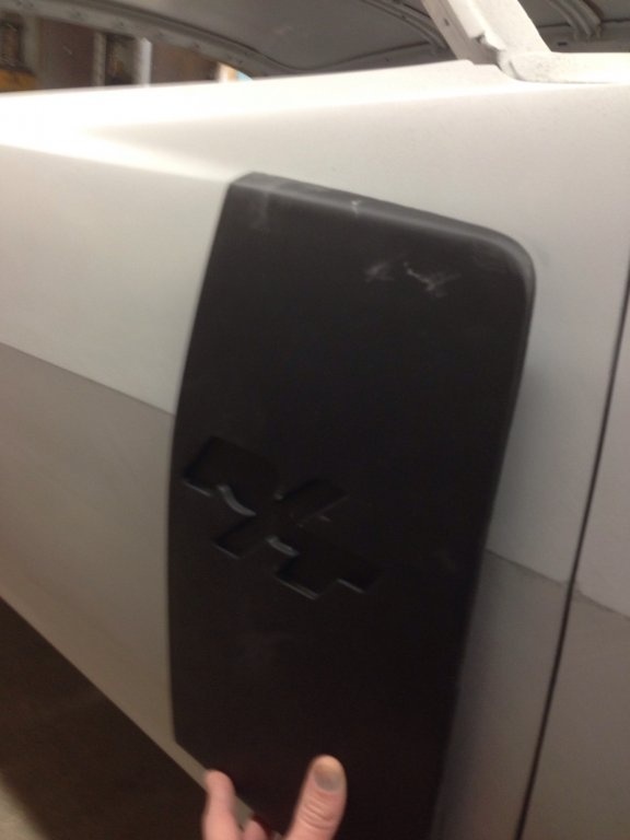

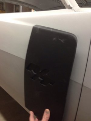

Received year one repo rt charger door scoops (1970)
Mounting holes line up well with original door holes.
Very sturdy scoops.
Appear to be about 1/16 inch higher than originals at the highest.
Recess for actual rt emblem not as deep.
Can live with it all and it's better than no scoops.
They are made out of very pinhole filled composite so be prepared to address that prior to painting.
It took 5 months from order to receipt.
All said and done, other than the wait time I'd order again.
