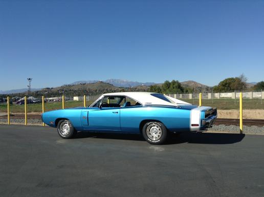

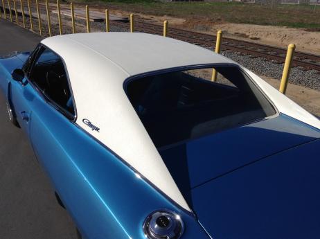

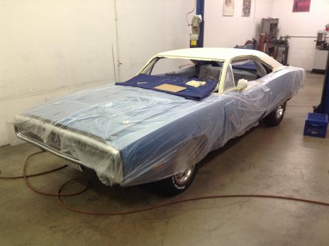

Well, since no advise was forthcoming here I found it elsewhere. Turns out, just as I had suspected, vinyl tops originally installed by most auto manufacturers in the sixties and seventies didn't feature seams at the top of A-pillars and that's the type we purchased and installed.
I even had the manufacturer make it "fresh to order", package and ship it rolled up to prevent any wrinkles, all which added to initial material and shipping costs but made the installation much easier with beautiful end results.

Well, it appears the (3 piece) vinyl top manufacturer was impressed enough with final results of this job to use couple of my pictures of it for their marketing, at least on their on-line March Newsletter.
I've attached same pictures in their original, un-cropped format, here for posterity.
