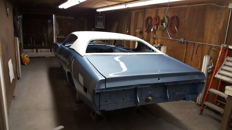

My experience with my '71 charger is that the glass clips are the same. However, the roof drip rail molding may be different due to the change in thickness because of the vinyl top being folded over the rail (or not). May have to consult the assembly manual. '71 charger vinyl top 2.jpg
