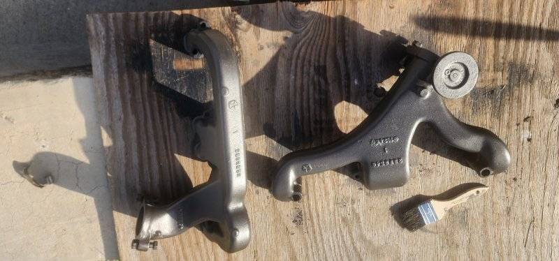

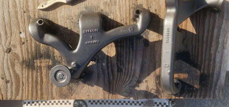

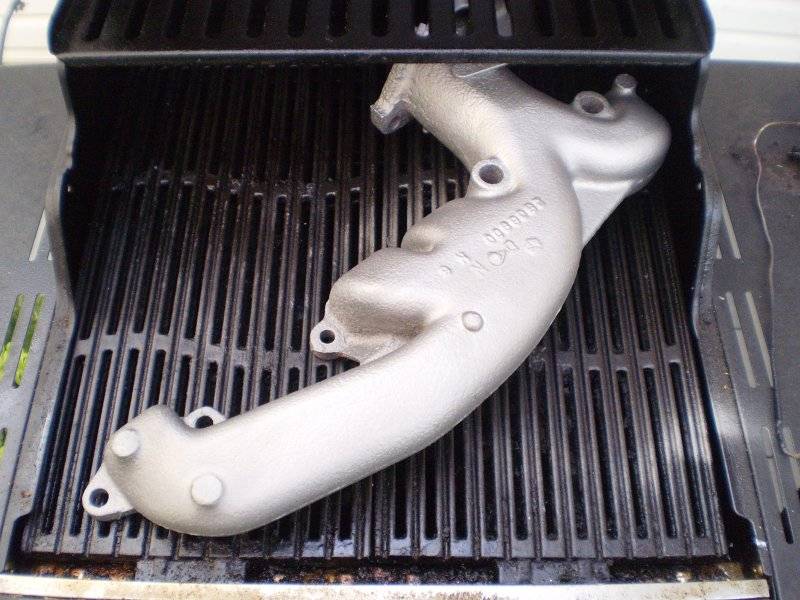

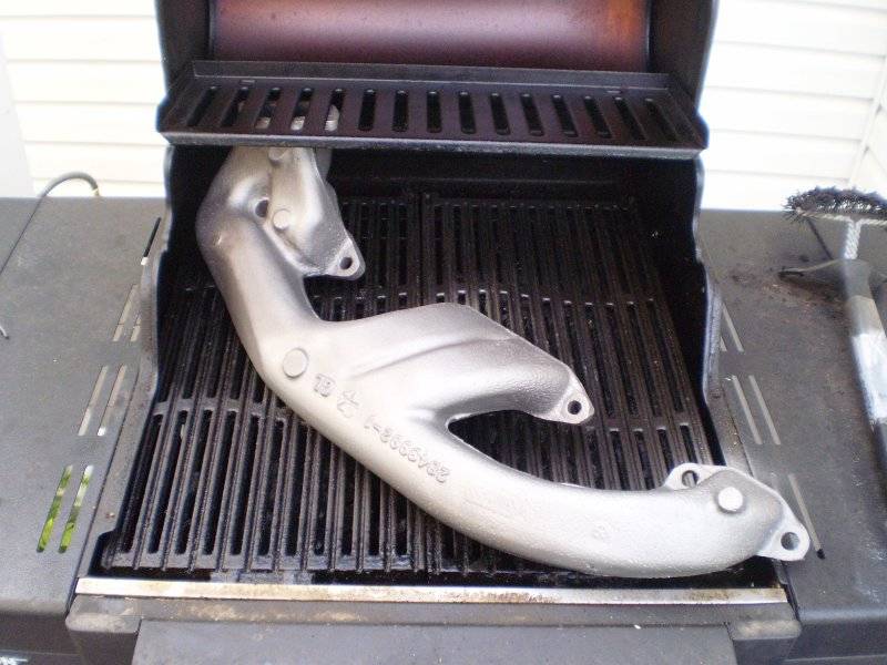

I recently did a set of 340 hp manifolds. I did a search on FBBO and several members recommended using slip plate.
I blasted mine and brushed it on. Looks great, supposed to last a long time,.

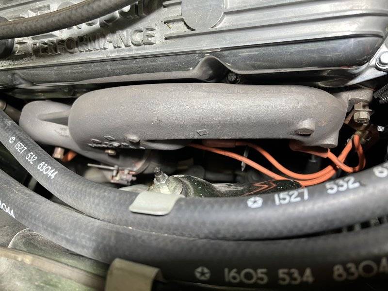

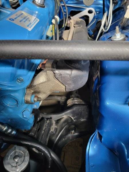

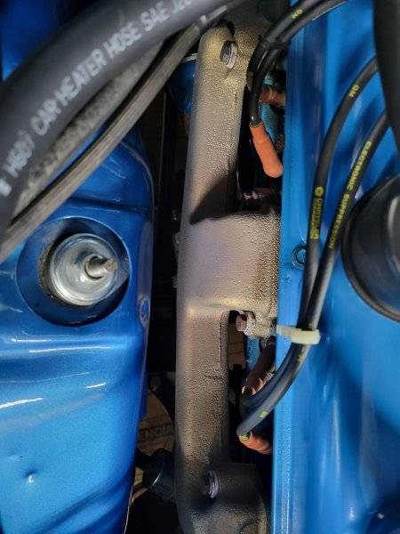

The factory put them on bare metal and then painted the motor with them in place, the manifolds got the same colour as the engine which burned off and then became rusty. If you want them nice looking forever definitely paint them with a Cast product. Mi have also used Eastwood high heat coating with a descent level of success

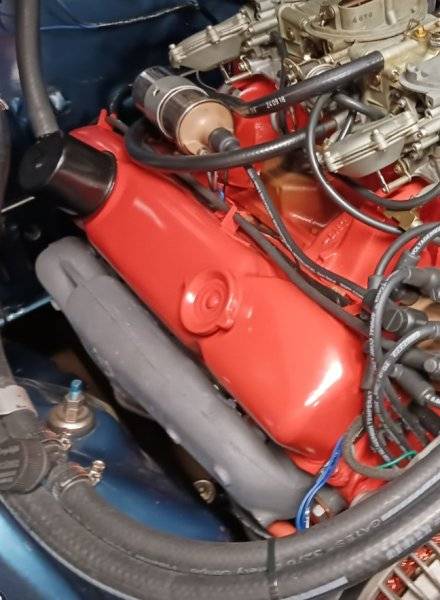

These pics will give you an idea of what the gray colored Eastwood brush on product will looks like. Mine were done almost 20 years ago and I would guess 15,000 miles or so (plus a lot of idle time heat cycles). They might have a clear now that you could use. Here is the link to what I used. Eastwood Factory Gray Hi-Temp Coating
