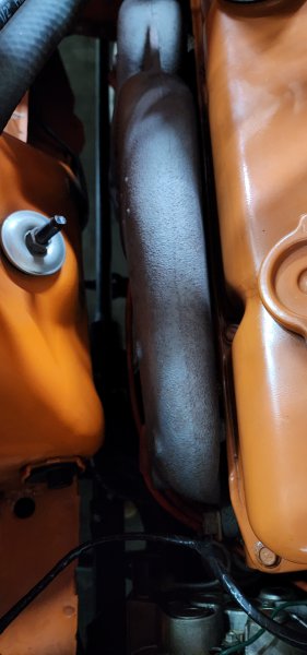

I restored the exhaust manifolds on my Superbird 25 years ago and coated with POR 15 cast blast coating. They cured with the heat of the engine when first cranked. I also replaced the heat riser with a kit so it works as designed. After 25 years there is only minor discoloration on the intake manifold, in the heat crossover area.
They are only noisy when they are worn out. I used cast iron header paint on mine. They have to be really cleaned of rust. Mine still look good after 3 years. Let the paint cure or follow their instructions. Rebuild the heat riser.
