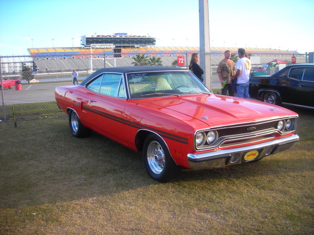

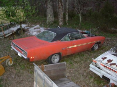

James listed the car for sale in Hemmings in 2007:

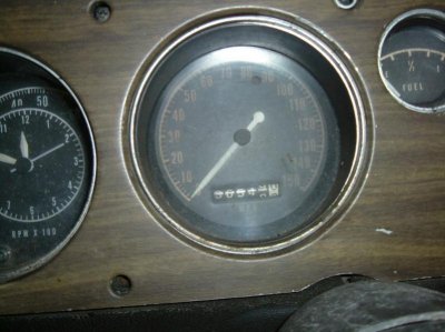

odometer pictures confirms most of the stories on mileage

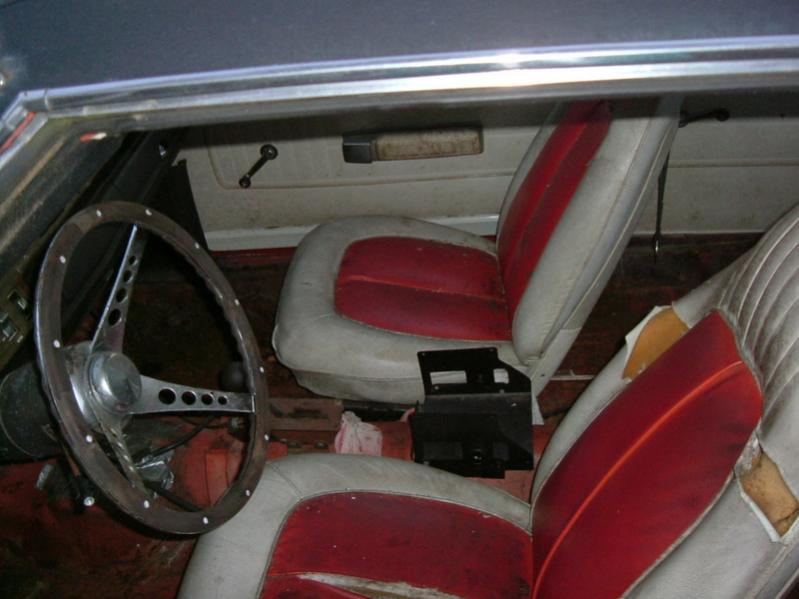

Mike had put the orange inserts in the seats "to get his butt off the vinyl" and because the "white got dirty if you looked at it".

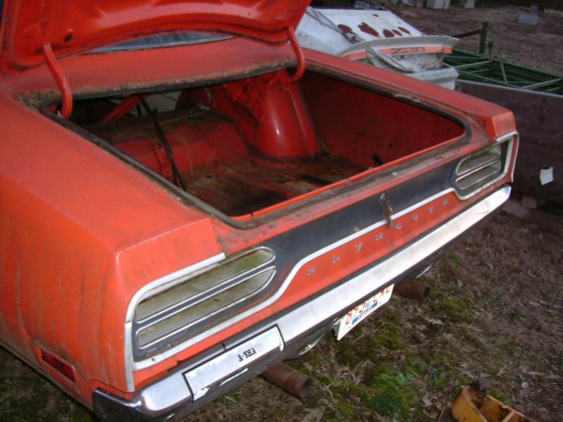

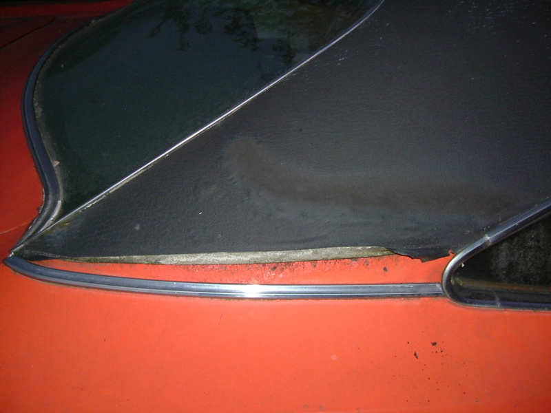

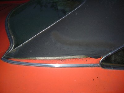

not bad under the vinyl top
a bit of rust around the back window and trunk lip
2007: H.B. bought the car with 36,500 miles for $15,500.
He bought the car with the 400 cu.in. motor, auto transmission and 8-3/4” rear-end. He put the 440-6 in the car and returned it to a 4-speed. He also did some cleaning under the hood. He had some rust around the rear window repaired and the car painted. Obviously he did quite a bit of work.

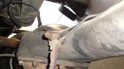

Lucky it wasn’t really “Wicked Fast” because the brakes would not have done the job …

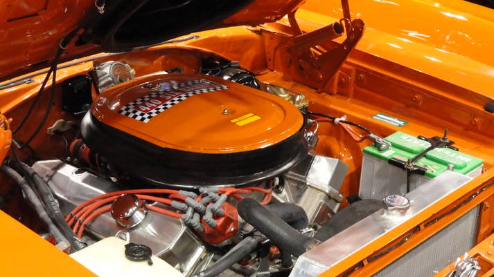

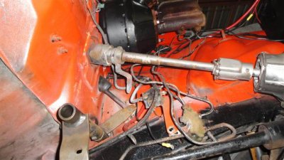

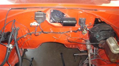

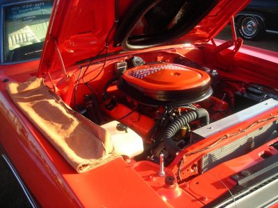

The engine bay was pretty clean, rust free and no signs of damage

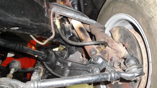

Had original brake set-up (front disc and 11” rear drums) but 14” wheels. Going to 4 wheel disc and will get the 15" wheel stipulated in the build sheet (code 71 15"x7" Road Rally wheels)

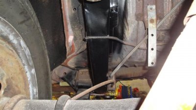

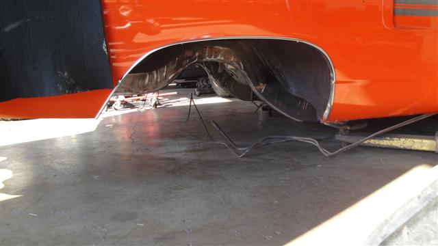

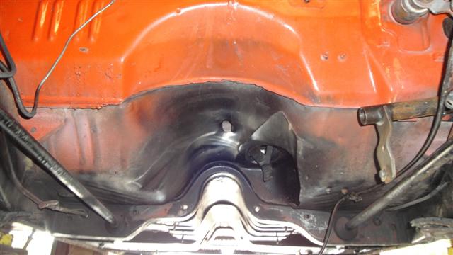

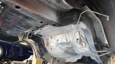

Wheel wells in good shape, no rust at all

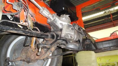

Big old steering box with about 4 full spins lock to lock, will go with Flaming River upgrade

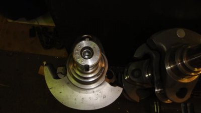

The crank was not forged (from a later model, after 72), so it was out and need to go to 440 Source for a forged one

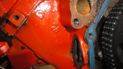

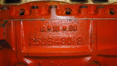

1968 440 block, but it was in good shape. It is the only engine component that I kept

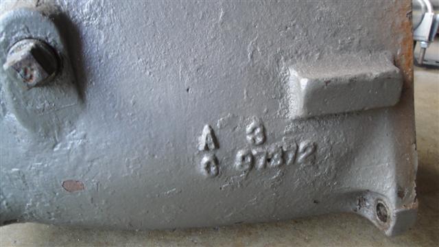

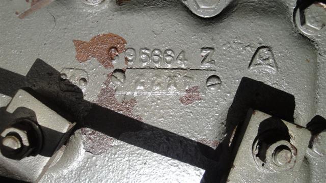

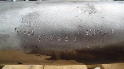

The trans was cobbled together from several models

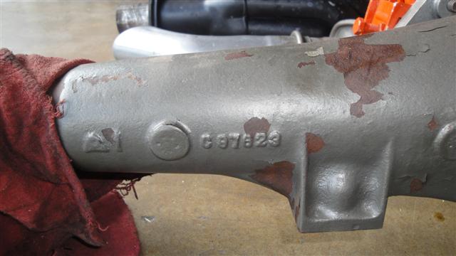

But the tailshaft was correct for a B-Body

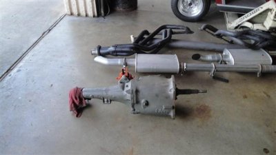

Tranny ready to be sent off Brewers for a proper build that can transfer 600+ hp
Those headers were replaced too, good shape but not good enough and won’t fit the new Indy heads. That “period correct” street drag exhaust system was headed for the dumpster and another chunk of change headed to TTI for a super fine 3” header back x-pipe system.

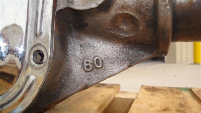

Got Dana 60 for it
with the correct BOM for a TrackPack 3.54

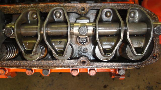

The valve train was in good shape but also had to go. Wanted a full roller set-up with the new motor. No use in nice new heads without all the goodies. There will be a bunch of 440 stuff on eBay soon!

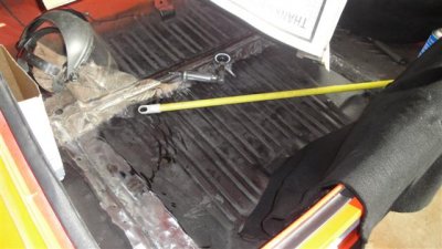

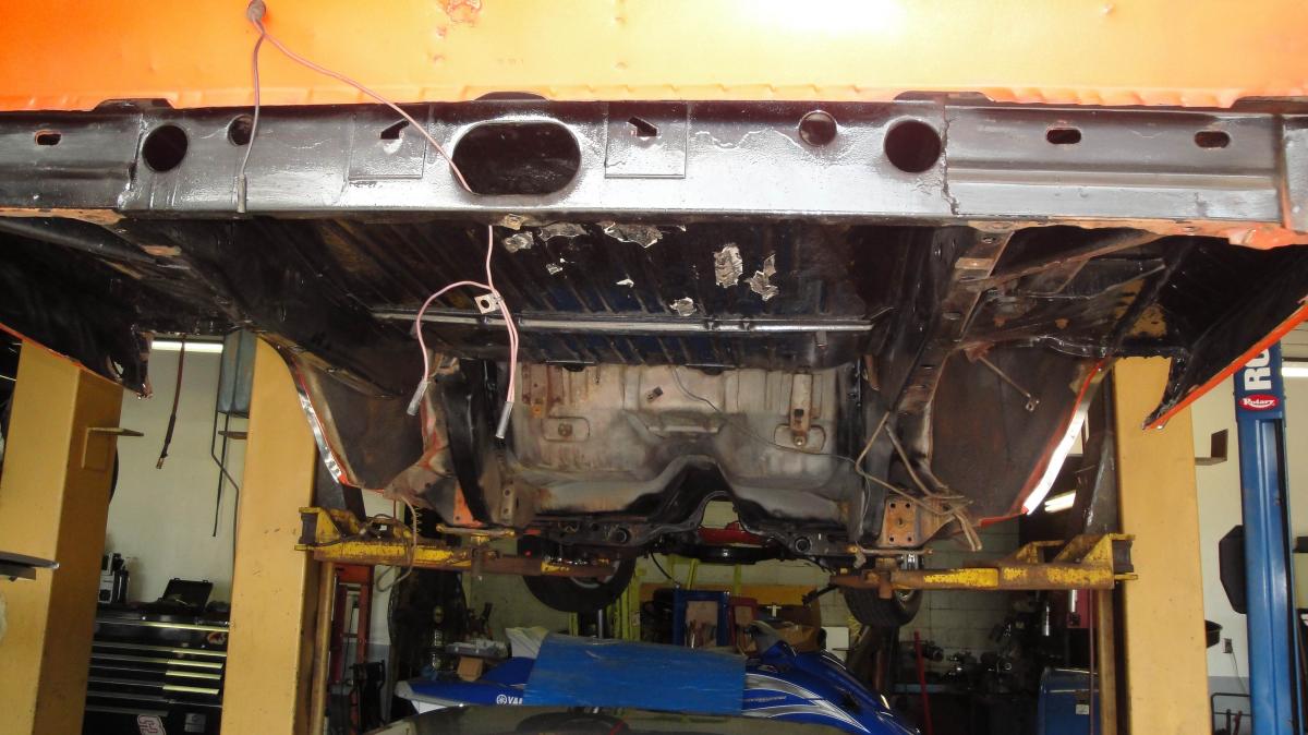

Trunk pan replaced, the only bad metal on the car.
and now headed in the right direction …

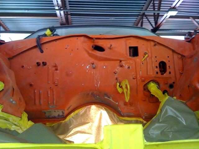

Ready for paint

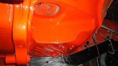

Inner wells sprayed with tuff coat. A lot of detail work addressed putting this together.

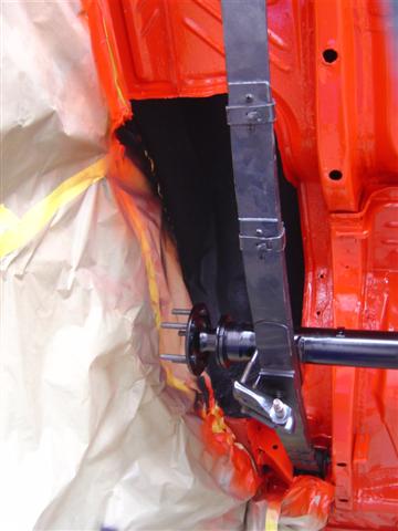

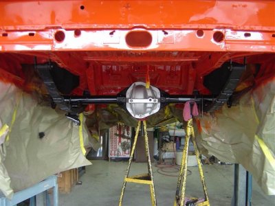

Dana and rear going in, could not believe the offset on the rear end!!!

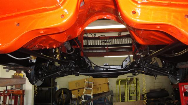

The K-member and front suspension went in just fine

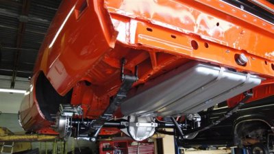

It is coming together very nicely.

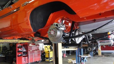

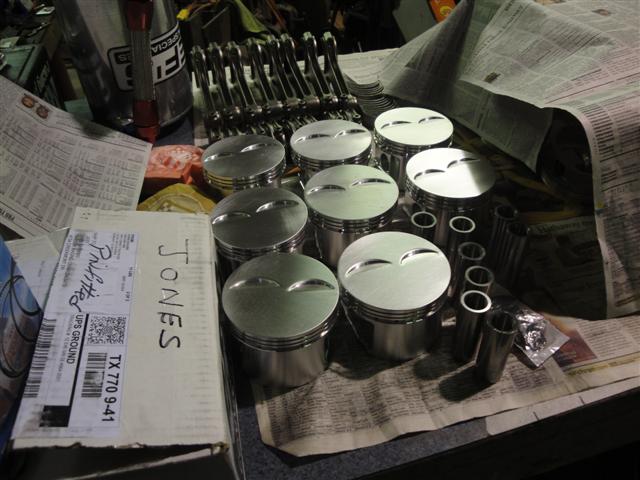

Building a reliable beast with all the best component parts

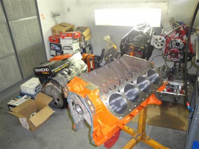

Decked, lined honed and ready to assemble

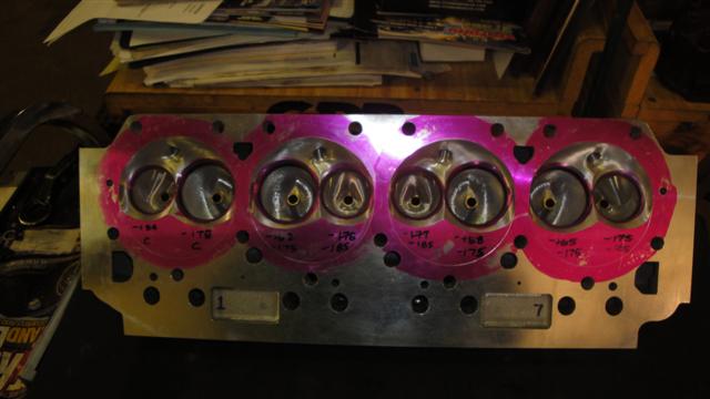

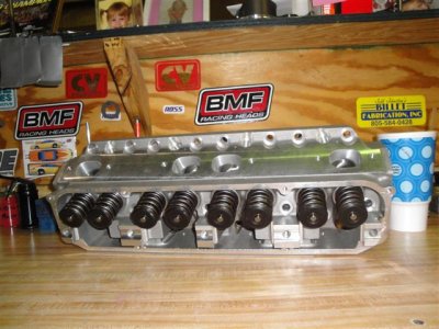

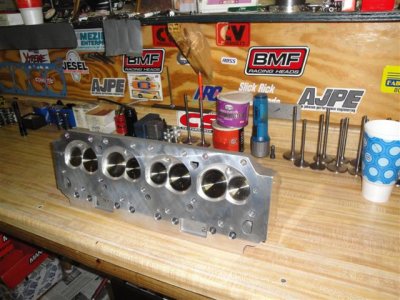

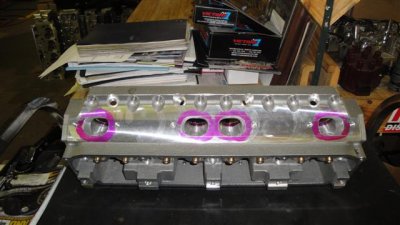

All head work on the Indy Heads was done by Slick Rick at Naiser Racing
Assembled and flow tested

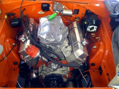

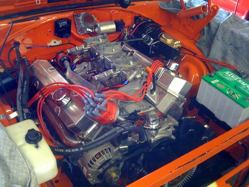

Snug fit for a fresh motor and everything new and/or detailed

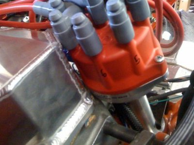

Super tight clearances in a lot of areas

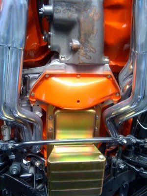

The 6-Pack just about gets my motor going

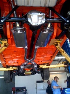

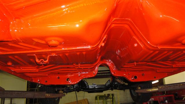

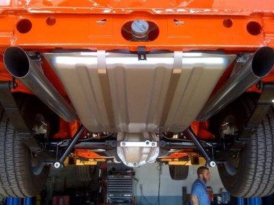

TTI makes a sweet system, install, fit, everything perfect
Need to cut the tailpipes to put the correct tips on

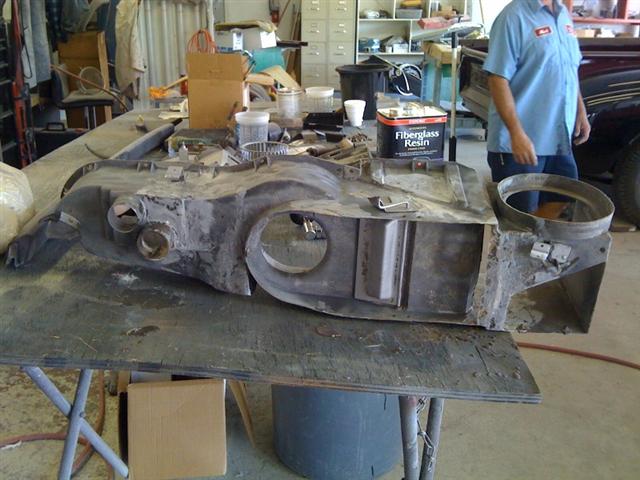

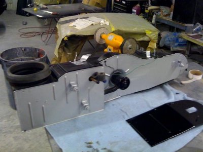

Every aspect of this car is detailed, even that which can’t be seen after assembly
heater box before
heater box after

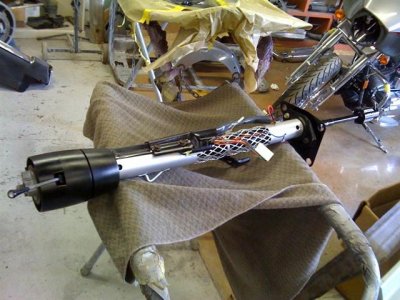

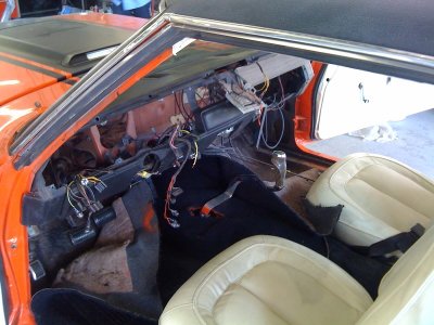

Dash is back in and it is time to redo the interior.
Steering wheel will also be on eBay as a correct 70 wood wheel will go in.
This time everything in the interior really will be “new”!

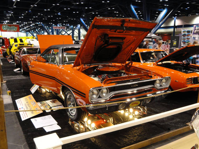

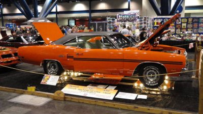

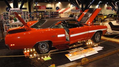

Car was entered in Autorama in Houston over Thanksgiving 2011
Car showed very well

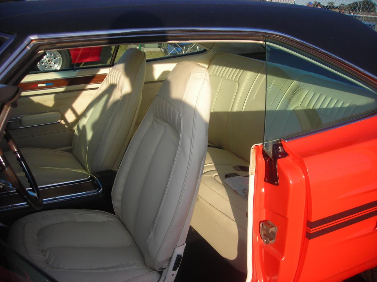

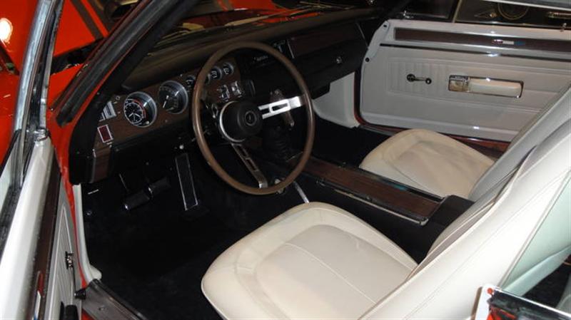

The interior does get dirty if you so much as look at it

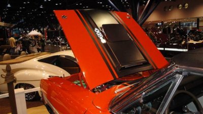

The build sheet indicated this car had the Air Grabber but not the hood decor package, but it just looks too good with stripes not to have them on
