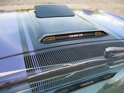

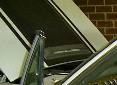

Hi Greg, It's not a great pic but it's the only one I've got at the moment. The metal section you can see bolts to the opening you have at the base of the hood. Inside the section is a glued metal inlay which designates the engine size. In the case of GTX's either HEMI or 440 goes there. Hope this helps.

That "plug" that fits into the back end looks to be a one year only part. Big surprise...I'm sorta used to that, owning a Mopar and all. I'll keep my eyes peeled. Thanks again.
