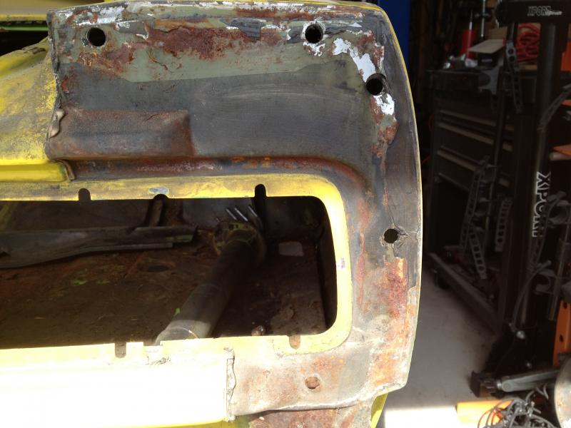

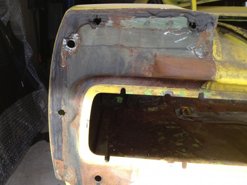

Here are pictures of my Road Runner. There was a thin layer of seam sealer that was spread around, but I did not see any gasket on mine.
It is possible these were taken off at some point and put back on the car, but this is how I found it...
Hawk

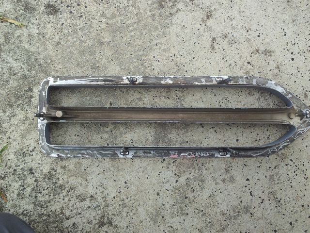

Thanks for the pictures Hsorman, but I was speaking of the actual taillight bezel not the fender extensions. Although I'm glad you posted these as I wasn't sure whether to put filler under them or make a gasket. So it's good to see how yours came off. Mine were taken off at the paint shop and I didn't see them till later after they were stripped. Looking at the rear of yours where the bezel goes it looks pretty clean. Maybe only a thin gasket or nothing at all. Looking at the picture of my bezel it has a thin layer of sealant of some sort but I didn't take a photo of the rear panel at the time and I can't remember what that looked like. I wasn't sure whether the sealant was original or done afterwards.

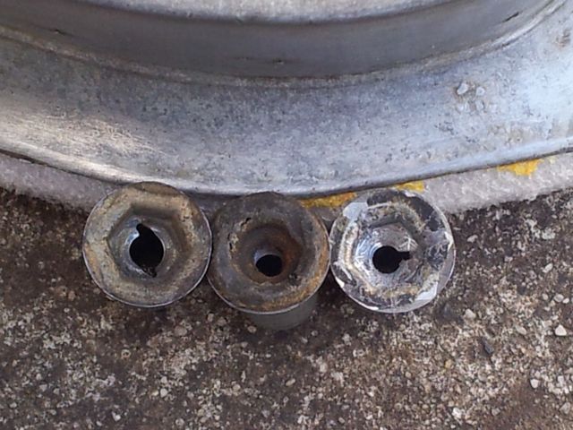

Finally got the acorns to thread on.
After screwing around for most of the weekend I finally managed to get the acorns to cut a thread. I should have done this right from the start.:head_smack: I gave up on the new repop acorns and grabbed one of the old ones. (I bought new ones because I was missing a few). The old one cut straight into the stalk and threaded itself on, no problems and didn't need too much pressure applied. The originals have two cutting edges and the repop only one. Even after cutting the thread the new ones are a pain the :pottytrain2: I took a photo of old and new so you can see what I mean. I dug out the putty on the new so you can see the one cutter inside. I wonder if they actually tried these repops before putting them on the market, I'm buggered if I can get them to thread on properly. You can see that the hole inside the new one is a lot smaller than the original. Thanks for all the replies guys.
Sorry Monroe, I obviously did not pay close enough attention to the text, and for some reason, I keep getting the quarter panel extensions stuck in my head. :iamwithstupid:
I am glad my wrong pictures were still of some help! By the way, for your original question, as you saw there is no evidence of seam sealer on my car (or the bezels). My taillight bezels do not have gaskets on them, but they were taken off and painted black at some point, so they are not a reliable indicator or what was originally done. I have to believe there was a gasket on them as described in other posts.
