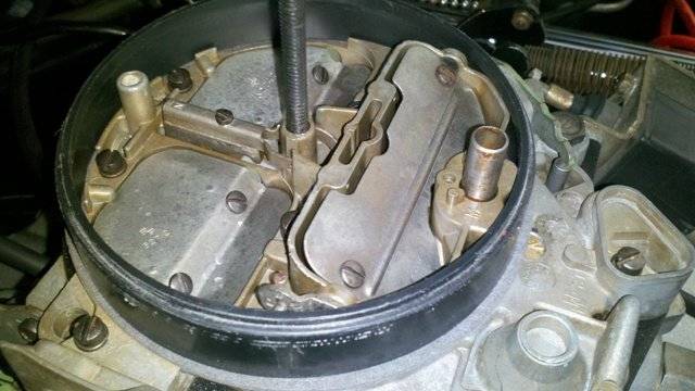

if the choke sets - this will work.

You really need to know if the choke is closing all the way when the engine is cold. If is sits for a few days then fill the center carb through the bowl vent.

I believe it needs to be fully closed but soon as the car fires off, the choke pull-off will crack the plate about an 1/8 of an inch.
there is an adjustment rod to set the gap with.
if you live in a very warm climate - the cold choke set like in the picture will likely work ok.
Even though you say "auto choke " and it kinda is; it could very well need adjusted. Spring tension, choke pull-off, etc.
