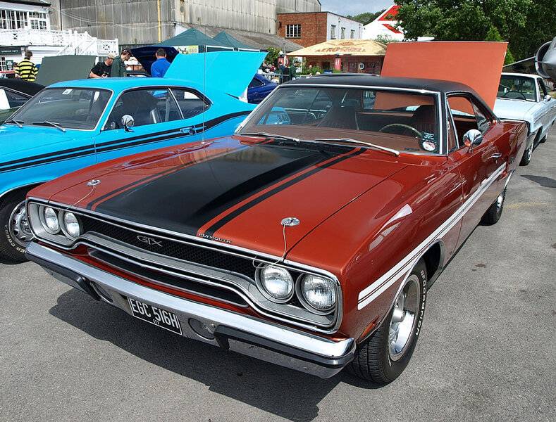

Jim's GTX at Brooklands and my mates Polara behind with a 512ci big-block coolio...
