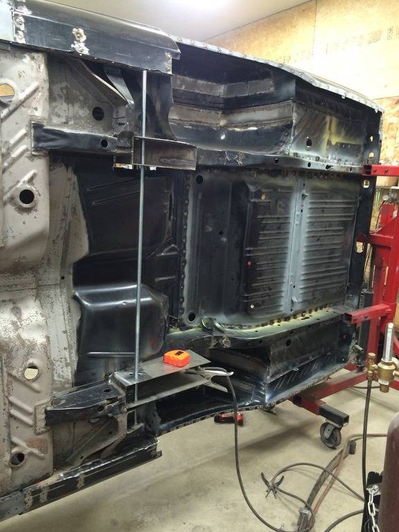

This rotisserie is the shiznit fo shizzle.... lol.. We got the rest of the trunk gutters all welded up. The shell is plenty strong enough to be twirled about at any angle. We rolled it over to start on the leaf spring relocation mess. I need these boxes installed in order to have the chromoly chassis tied into it. We cut out one side frame rail and did that box first.
We lined up all the holes by running a 5/8-11 threaded rod all the way through the original hangers and my boxes. The original hole lines up with my bottom hole. I have two more holes on up allowing me to lower the car up to 4 inches. Combined with the -1" caltrac split monos, it'll be low.

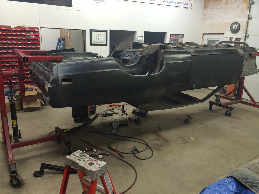

Then we rolled the car over the other way and cut out the passenger side.
This is the ONLY way to work on the bottom of a car!!
When you cut the frame supported on each end with the car tipped are sure the car didn't move out of square???
Gary
We just did one side at a time. Zero movement.Loving the build.Question,what did you do to insure that the car remained square when cutting out the frame for the relocation?I would be afraid it would move .
