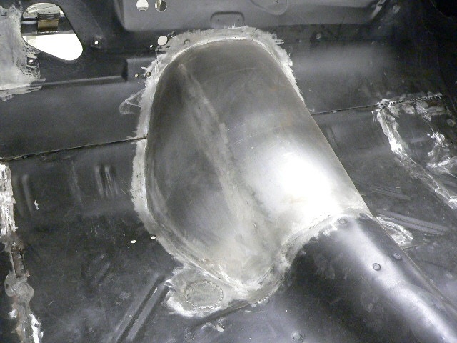

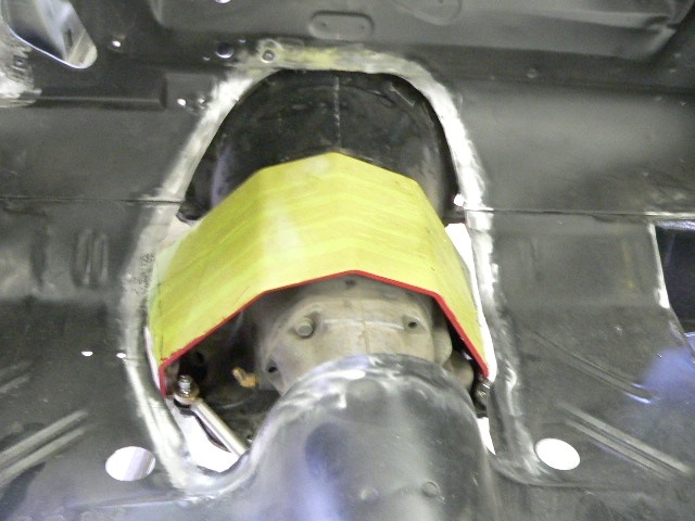

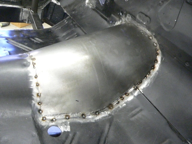

Thanks for the advice looks like I might get the car. I was planning on reshaping the tunnel for a future 5 speed conversion. DVW how much did you widen the tunnel?
Aproximately 4"wider and 2" taller. It was really pretty easy. Cut the hole. Roll a piece of sheet metal (I used 10" PVC pipe ). Push it up from the bottom. Tack weld, trim the excess, and finish weld. Mine was done for shield clearance and ease of trans removal. It comes out in 30 minutes.
About 4" wider, 1-2" taller. a few more pics.

Nice work DVW was noticing the gas pedal mounts looks a bit tight but nice indeed

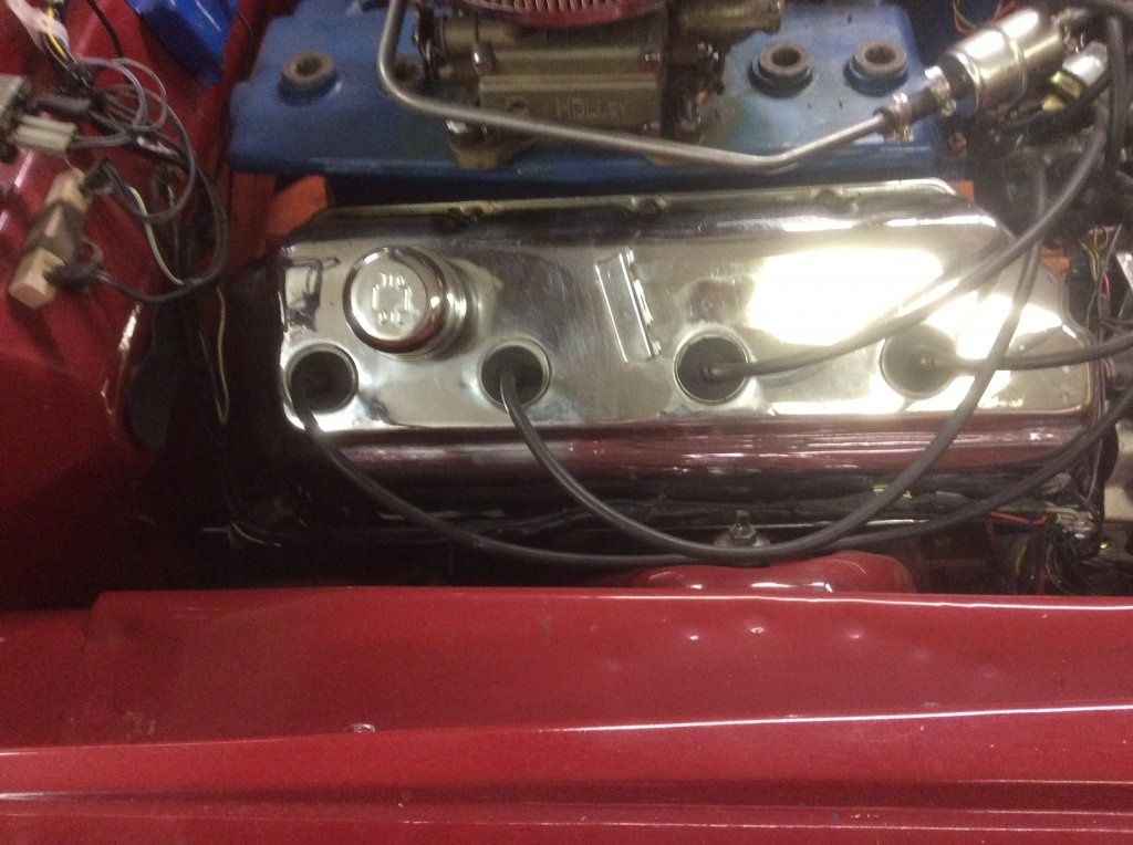

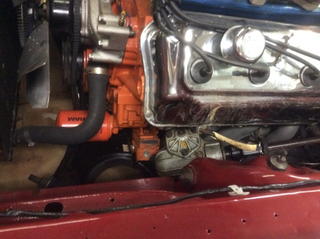

Long time come 'in Hemi in 65 Dodge Coronet. Traced engine mounts off my 66 Hemi Satellite so I could make engine mounts for the Dodge. Bolted mounts to engine including the mounts for the k-member. Positioned motor so mounts fit and tack them to k-member. removed and finish welded mounts. Have a Lakewood blow shield have to modify trans tunnel first. Probably need to jack motor to adjust valves or if real lucky just unbolt shock. Crossram is 3/8" from firewall. I have a new set of valve covers to go on in the future.
Ahhh,rough em up,spray em with black crinkle paint and your good! Or send em to me....lol.
