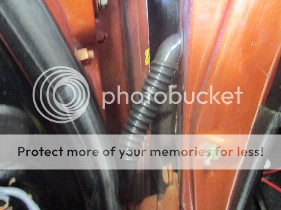

Hardest part (for me anyway) was had to remove both front doors in order to be able to drill the 7/8" holes for the wiring boot for each door and the door frame. The actual installation of the harness was pretty easy but do take note I chose to mount the 4 gang master switch in the center console...no switches on the doors or the rear interior quarter panels...wanted have a clean look when all is said and done.

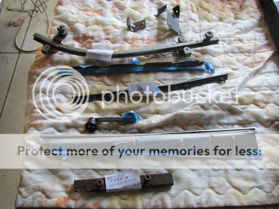

First things is there a re about 5 or 6 pieces that have to be removed along with the trim around the top of the window cavity (see the photo below)....you will need as much space as possible to get the window out.
Once you are ready to try and remove the regulator (after you have removed the three mounting bolts) pull the window up along with the regulator attached (there will be just one regulator arm left attached to the mounting plate ), it will take two of you to raise the window out of the top pulling the regulator with it (make sure you have a pair of hands on the bottom and two on the top...don't want to bottom mounting plate to pull loose from the window) and once you have the mounting plate out enough to dis-engage the one regulator wheel then you can lower the regulator back into the cavity and pull the window assemble out the top, then you remove the regulator out through the hole at the bottom. Takes some manuvering but it is do able.

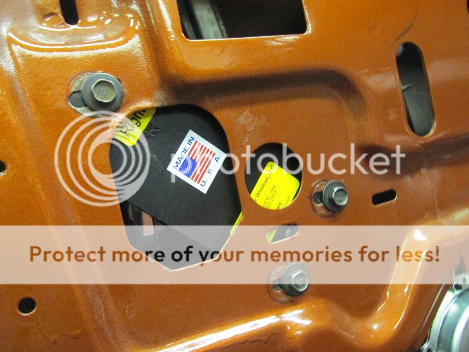

Now this is very important...the mounting holes for the rear regulators are slotted (front are not)...the new power regulators would only fit correctly if the mounting bolts are pushed all the way to the rear (see photo), if not the regulator will not sit straight and the rollers on the regulator arms will not fit in the tracks correctly.

Parts that had to be removed from one rear regulator cavity b4 you can remove the regulator & window

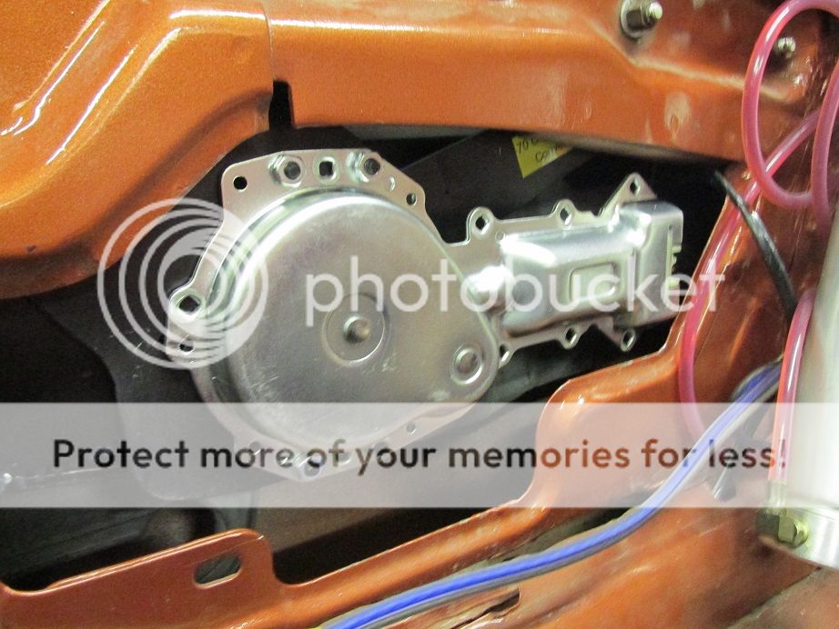

The new rear power regulators
Note how the regulator mounting bolts sit in the slots (pass side rear)
Regulator installed in pass side rear (note how it sits in relation to the opening)
Wire boot for driver's side door

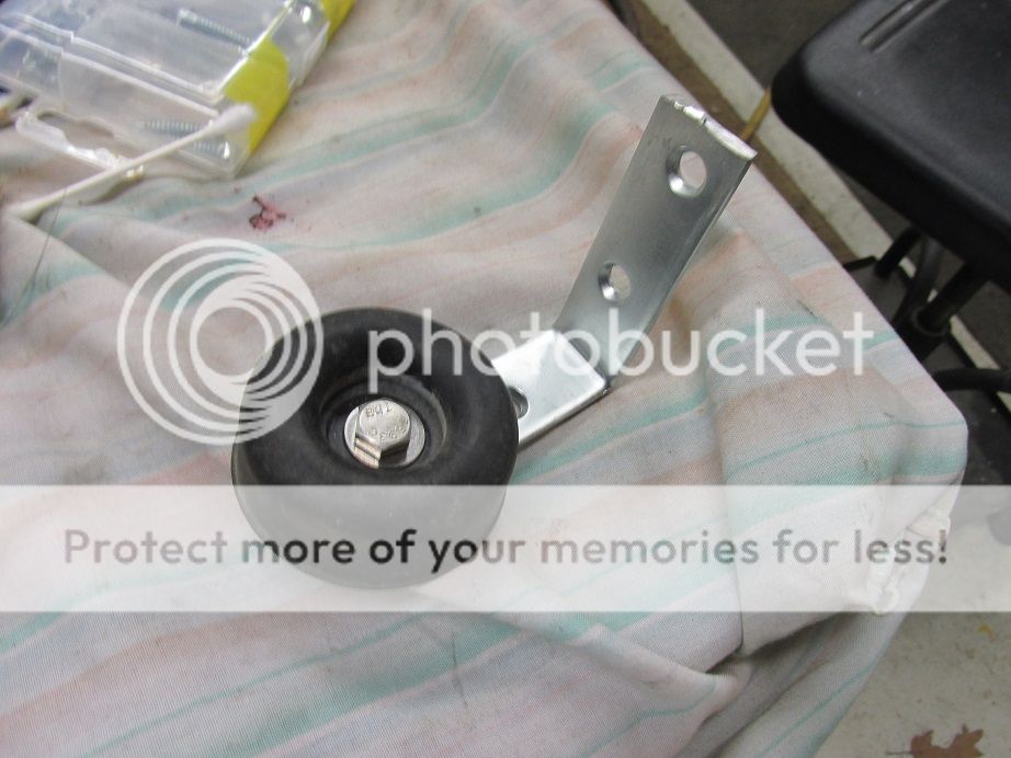

Extra rollers, push springs and spacers that come with the kit

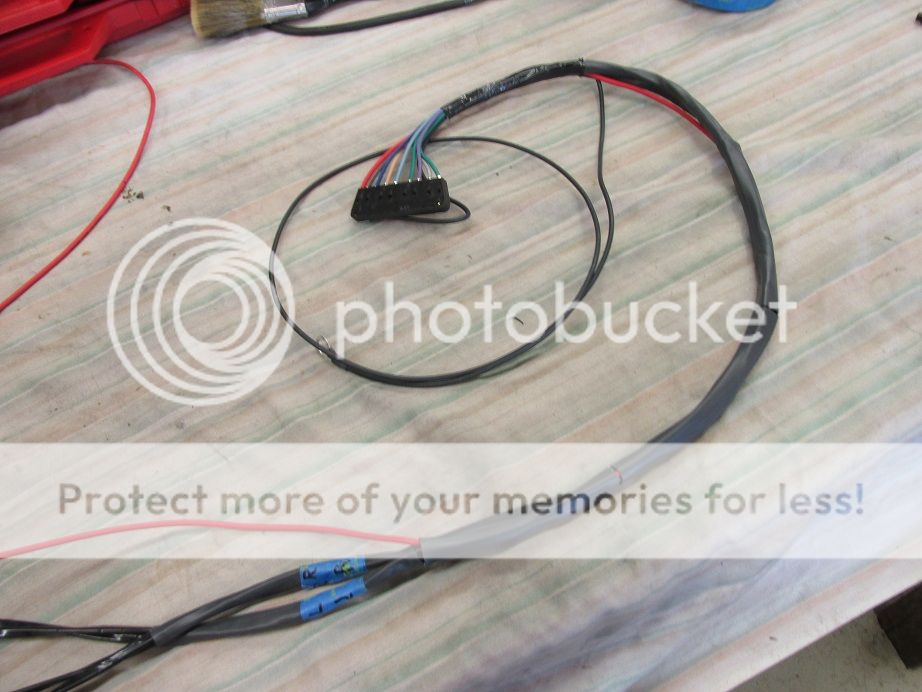

Addition of some shrink tubing I used on harness where it will fit under the dash

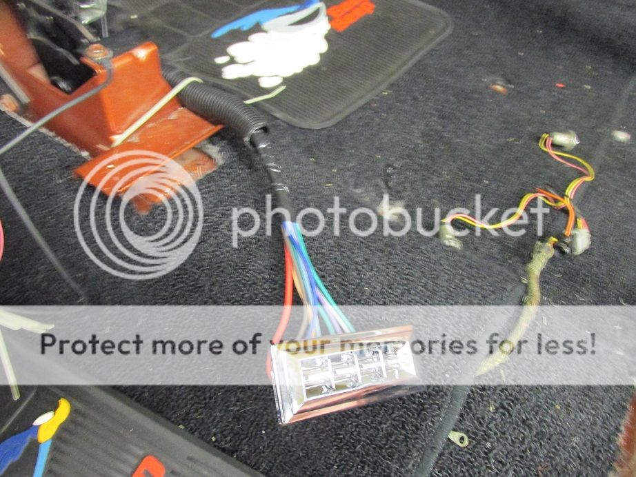

Placement of 4 way switch waiting for the console to be installed
Photo of part of opening in the console for the 4 way switch
