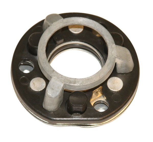

The contact plates are stuck together. Use a small flat head screw driver and open them up. Also while your there, take some sand paper and clean in between the 2 plates then use some die electric grease between those plates.
I not sure what contact plates you're talking about. I took the horn ring assembly off the steering wheel & the horn still blows. I'm getting ready to get into the column & check the wiring harness . I also disconnected the turn signal wiring harness & that stopped the horn. Any suggestions are surely needed.
Chuck
This is what the switch looks like, there are two contact plates held apart by springs, when the plates touch it completes the circuit and the horn blows.
Make sure that's not the problem first.
I do have that off the steering assembly already. It isn't stuck. I believe it is working properly. I have a new relay hooked up, the switch is off the car & when I connect the battery, the horn beeps. When I disconnect the turn signal wiring connector under the column, it stops beeping. Can I assume something in the wiring harness is bad ???
