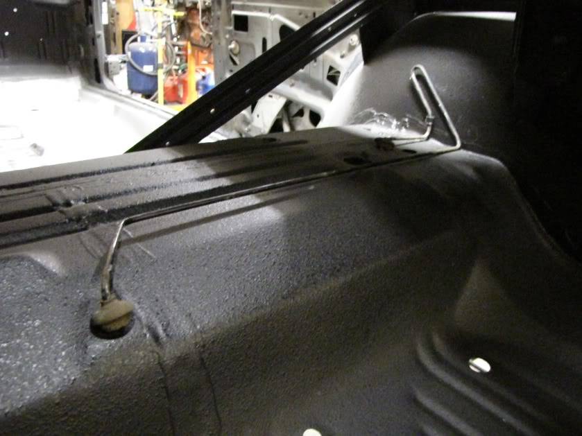

Plumbing the fuel lines and vents.I know the one vents through the small tube and into the frame rail.Where does the other go to.Tank was out of the car when i got it so i have no clue.
Jay,
Vent line goes up through the trunk pan at the rear axle hump..I'll get you a picture here tonight yet..
I layed the old vent line pretty much in place for ya........Hope it helps

Only the CA cars had that set up.This car has 2 vents,1 vents to that small tube into the rail.Where does the 2nd one go?
Somebody has to have a pic or idea how the 70' fuel line vent set up (non CA) is in the back....stunned.

My 70 Satellite has 2 vents. Will try to clear away the debris later (if I decide to warm up the garage) & see where they go.
Checked it out, just like the photo by Propwash. Line comes up thru the floor, has that goose neck & then goes back thru the floor & terminates. The penetrations have large hole grommets. The short line just extends up into the shock mount rail, turns horizontal and terminates.
