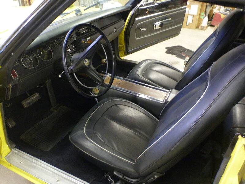

anyone have pictures they can post of the stock steering wheel and horn setup for 1970? I have seen several different setups and want to make sure I get it right.
Thanks!!!!

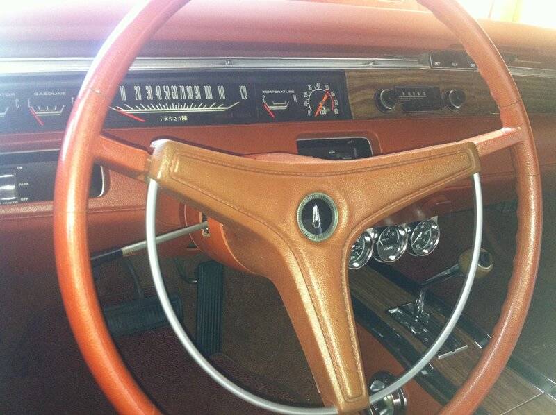

1970 Sport Satellite
perfect, I have the correct ones. Now to find the black horn ring or whatever that thing is called. Thanks.
If you're trying to get it right then you need to know which wheel setup your car came with. The choices are S78 - steering wheel with full ring horn pad, S79 - steering wheel with partial ring horn pad (that's the one above), S81 - woodgrain sports wheel (I don't know if this was available on B bodies in 1970), S83 - rim blow steering wheel and S84 - Tuff wheel. Then there's color to consider on some of these. Don't forget the center medallion, I believe the Roadrunners had a Roadrunner center medallion and in 1970 only, the S78 & S79 had a pebble grain texture on the wheel. Just some things to consider.

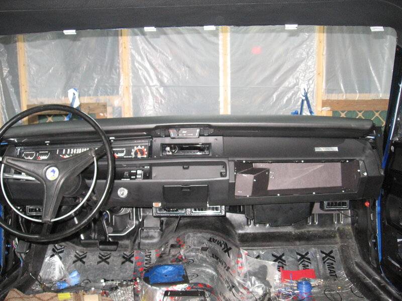

Yes what Geetex said. Mine is a 69 and found one for sale off another forum. It works well in my 69 Runner RM21
I have a green one like those for sure. Now need to find a good black one.
