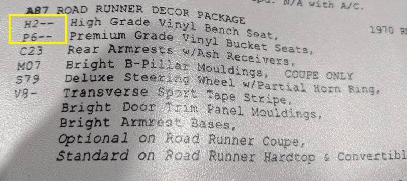

Hi, The fender tag has a "A87" which is not clear whether the car came with bench or bucket seats, how can confirm which one? or does this refer to front buckets and the rear bench?
thanks Joe
look on the floor and see if it has reinforcement plates welded in
Whats your code on the tag next to the paint code?
Fender Tag should read something like H2X9 after the paint code.
H2X9
Trim Grade/Style/Color
H = High
2 = Vinyl Bench
X9 = Black
Wow what a great website huh, but I would have agreed with the other post I think the bolt pattern on the floor pan is different
I’m going to check
I’m going to check the floor also today and post a picture. The car supposed to a be front bench and see if the floor confirm this.
