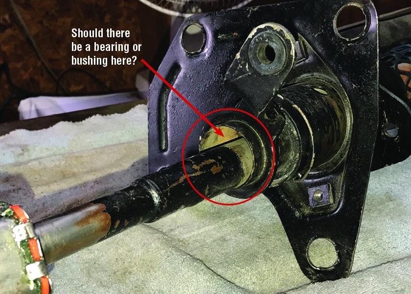

Is there supposed to be a bearing or bushing at the bottom of my 70 Roadrunner Auto on the column steering column? My steering shaft comes out of the end at an angle and touches the end of the column tube. Im sure this is whats causing the short in the horn etc. See the picture below.

There is supposed to be a bushing/bearing in there but it does nothing but u can adjust the steering column around to clear that from hitting

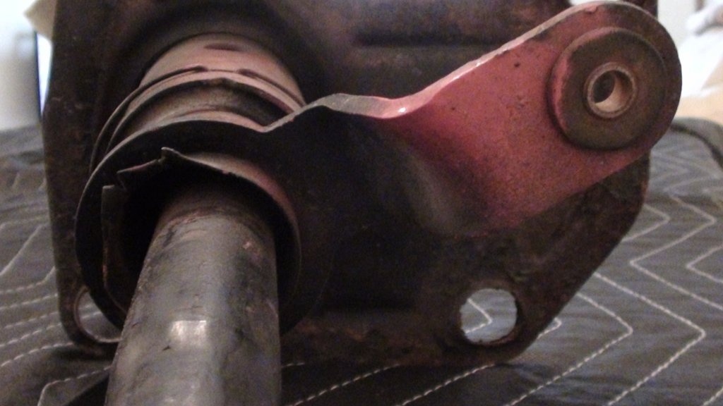

No, 1970 steering column does not have a bearing or bushing their. 1968 and 1969 columns did. Just rebuilt mine last year it is free floating. If you need any pics or question about it just ask me. Had it all out of car and took pics of the whole tear down process.

Hey thanks DP, I didn't think the 70 had a bushing there but was not sure.
