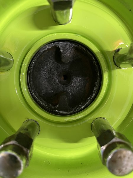

I installed the following 4 wheel Disc Brake Conversion Kit. The Right Stuff 1962-72 Mopar B/E-Body, 8" Booster, 4-Wheel Power Disc Brake Conversion Kit - (MDC42DC-P)
I purchased the following rear wheel rims. https://www.classicindustries.com/shop/all-years/dodge/coronet/parts/?q=MW860
I am unable to hug the center hub with my rims. They are connected to the hub only by the studs.
Is there an adapter that will extend the center hub only; not the entire hub? (i.e. spacers).
I thank you all in advance.

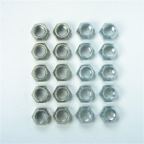

Looks like you will need some different lug nuts. Non- hub centric. Maybe lug centric. Something like that.
Lug nuts are a fail. Are they bottoming out on the studs? Get some open end stock lug nuts and go from there.
The lug nut are only there to hold the rim so you can see the rim center hole does not go over the center hub. I'm going to use tapered small nuts. Imaged attached.
So the hole in the rim is smaller than the outside of the hub? If that is the case you will need a different rim or different hub.

You'd think those wheels would go over those hubs. I see you have painted them. I wonder if the stock finish (powder coat?) + the paint job could be what's causing them to not quite fit. They sure are close. Then again, paint ain't that tough. Unless I am not quite understanding the issue.
The way I am understanding it, is the rotor is a lot thicker than the drum so the center register does not protrude far enough to fit into the wheel center. He wants the wheel to be hub centric. He can run the wheels lug centric or have the hub extended on the axles, or thin the rotor flange a bit if that is possible. I could be wrong but that is the way that I read the problem.

He can't get the center of the wheel over the center of the hub, it is too small. He needs to make the center hole bigger, then he will need new lug-centric lug nuts. That is the way that I am understanding it.
I'll start with the rotor. Is it sitting flat against the axle flange? Or is the rotor hole slightly under size to sit flat? Also rotors are about an 1/8" thicker then the drum so you loose a little there.
No, They are the same size. It appears the brake setup takes to much space because of the thickness of the rotor and other components to connect the calipers. I'm just asking the question because many people here have modified their B-body to four wheel disc brake. Perhaps they have experienced the same problem with the parts that I have used and have a solution. That is why I provided the links and pictures so you guys know the combination of wheels and braking system I installed.
As long as you have matching seat taper on the nuts and rim, and they are tight, there is no need to have the hub touching the rim.
