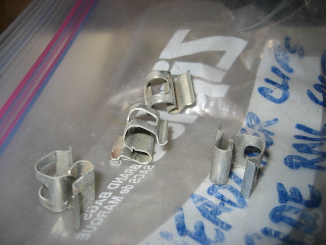

Yes they are 6 for each side ,not sure what they are called ,but they slide into the metal strip 3 in front of post and 3 bhind and clamp onto the pinch weld.mine are a silver color but bare metal.kind of a u shape.12 total
Headliner Pinch weld Trim Clips
Pictured are a few

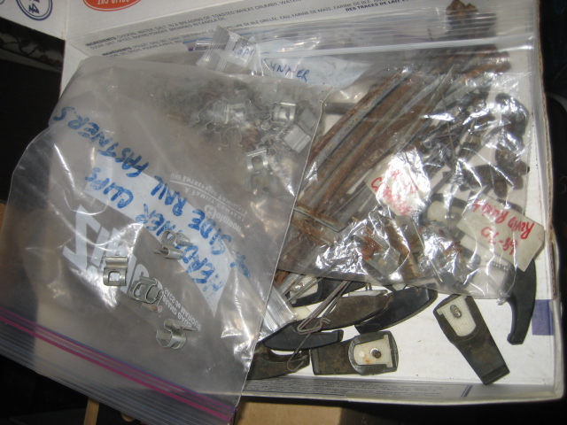

Thank you, gentlemen. Much easier to find something in boxes of assorted parts when you know what it looks like.
Found 'em in an envelope marked "reveal molding clips". I think the guy was channeling '57 Chevys.
