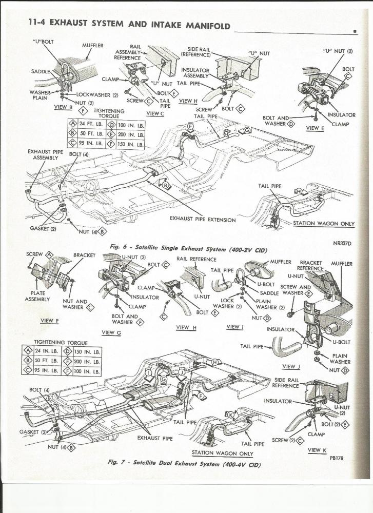

I have a strange question that I could not find on here. I am working on removing all of the under coating from myuys 72 Roadrunner and am having an issue removing the exhaust. I see where my brother had after market mufflers put on and the shop just welded it to the seat belt reinforcement places. I was wondering if anyone had pictures of what stock brackets looked like and where I might be able to find them with hardware. Once I get the underneath cleaned they will need to go back in and I would like to try and make it original again. Any pictures would be an amazing help.
Thanks Guys!
I have a PDF File taken from 1972 Chrysler repair manual. File is larger than allowed by this site 676 kb anyone have any ideas on how to attach then to this thread. Have pic's of exhaust extensions also.
