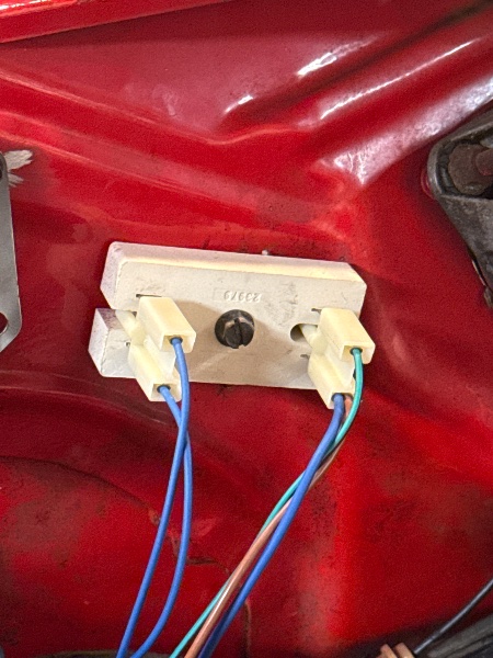

Is your wire for electric choke going to the positive side of ignition coil ?
If it is , disconnect that positive wire to electric choke for now and see if it starts and try’s to stay running
I am confused with your readings at ballast resistor
With key in run position
Do you have any VOLTS at positive side of ignition coil

Bee1971. Electric choke disconnected. Awesome. Ok. key in ‘run’ position. Probe to the neg battery and positive on the Ignition coil I have 5.6v.
I'm thinking ballast resistor also.
gkent, r413, and 493 Mike, swapped the ballast resistor and it fired and ran for 15 seconds and then died. BR taken off and tested fine. I think it’s going back to the bulkhead connector as Bee1971 said. I just gotta learn some basics of a test light. I’m a helluva part swapper. Electric diag is obviously not my strong suit. ‍♂️
Just take a wire direct from battery to the run side of the ballast wiring. Hit the key and I bet it runs, then work backwards to find the failure point.

Likely the parts replaced had no impact, but moving the wires around during the process got it to run, then the bad connection reappeared. Quit replacing parts, you've got a wiring issue.

Dadsbee.. yes. Just did it. Wire from the Pos to the ‘Run’ (or left side). Put the key in ‘run’ and jumped it. Tried twice. Then a little brake cleaner as motivation down the gullet, and it fired up and ran. I let it run for 3 minutes. Turned it off, removed the jumper wire and turned the key. Fired up and ran. 5 more minutes running smooth. I turned it off and turned on again. Success. Waiting 20-30 minutes and tried again. Success. Now my paranoid brain thinks it’s going to be an intermittent issue. So I’ll turn it on and start wiggling stuff. I wish I could put my finger on the ‘bad part’.. but electricity is still voodoo to me. Thank you guys for your guidance. I appreciate it more than you know.

Long story short, it was the 4 prong ballast.
I switched to the factory recommend 2 prong and left 2 plugs unplugged.
Problem solved.
The resistance was brought up earlier in this thread, that was my problem, hope it is yours and you get it figured out.

Great suggestion! After swapping the remaining old parts (disti and coil) and giving each connection a jiggle, it fires right up. Runs smooth.. shuts down and fires again. Next test is wiggling connections while it’s running. Then I take the leap of driving around. We’ll see.
