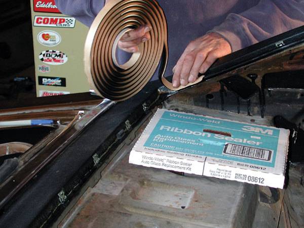

easy to install... required the window ribbon sealer to get the glass glued to the body. Use couple of rubber block spacers to keep the glass in place on bottom.

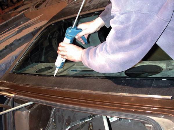

Once glass is in there, then fill the chanel left between glass/ribbon and body with buthyl window sealer... specially if vinyl top
Urethane can be used too instead the ribbon sealer, but, once again, once urethane dryes, fill the channel with buthyl sealant to save from dust and humidity storaged there. Will save from any posible gap left by the ribbon due the body irregularities too
ribbon sealer works like a double faced tape ( even actually is really like a clay ribbon )
Then buthyl to fill the gap left between ribbon and all the glass opening perimeter
