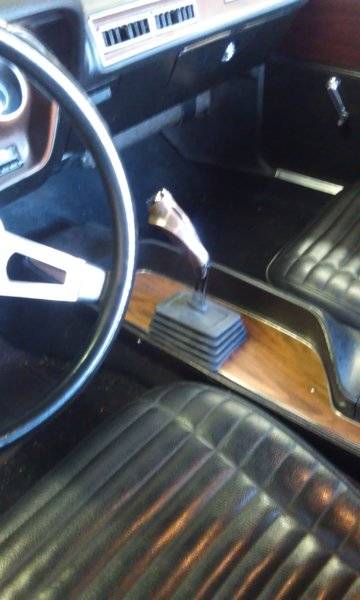

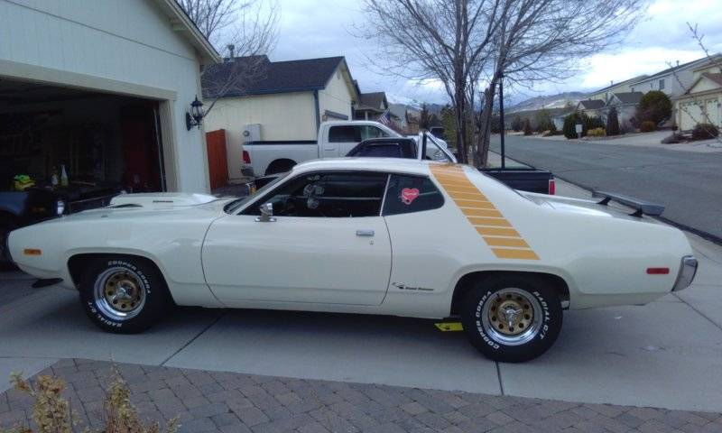

I am currently getting over 20 MPG from my 72 RR Clone. 318, Holley 390 Cfn 4 barrel, dual exhaust, stock exhaust manifolds. 318s had two different heads. The 2 barrel had smaller intake runners. If you add a aftermarket 4 barrel aluminum intake you create air disruption since the after market intake has bigger runners. I put an intake from an 80s Diplomate that had the smaller runners. Perfect fit. The 390 CFM holley is fantastic. I also have 2:71 gears. I shift my car manually, is an automatic. I run first to about 30, then 2nd to about 50 then 3rd. Many people stand back, since they do not know what my engine is. I have a lot of fun with new Corvettes and others. I also have a FAKE 4 speed shifter. Check out pictures.
Awesome car!!!
Thanks for the info. Any idea what part numbers your manifolds are or what year. Are they stock 318 manifolds or 340/360 manifolds. I am still deciphering all the differences.
View attachment 886393 View attachment 886397
