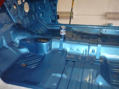

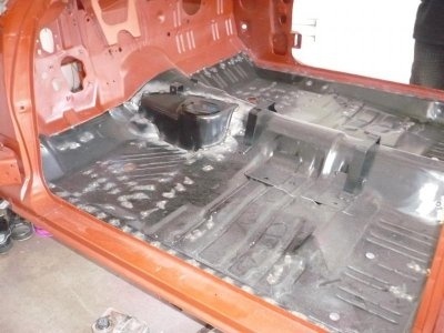

THIS IS MY 69 PAN AND HUMP. AMD MAKES THE RIGHT STUFF YOU NEED. HERE ARE SOME PICS OF WHAT I HAD TO DEAL WITH..

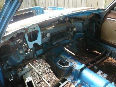

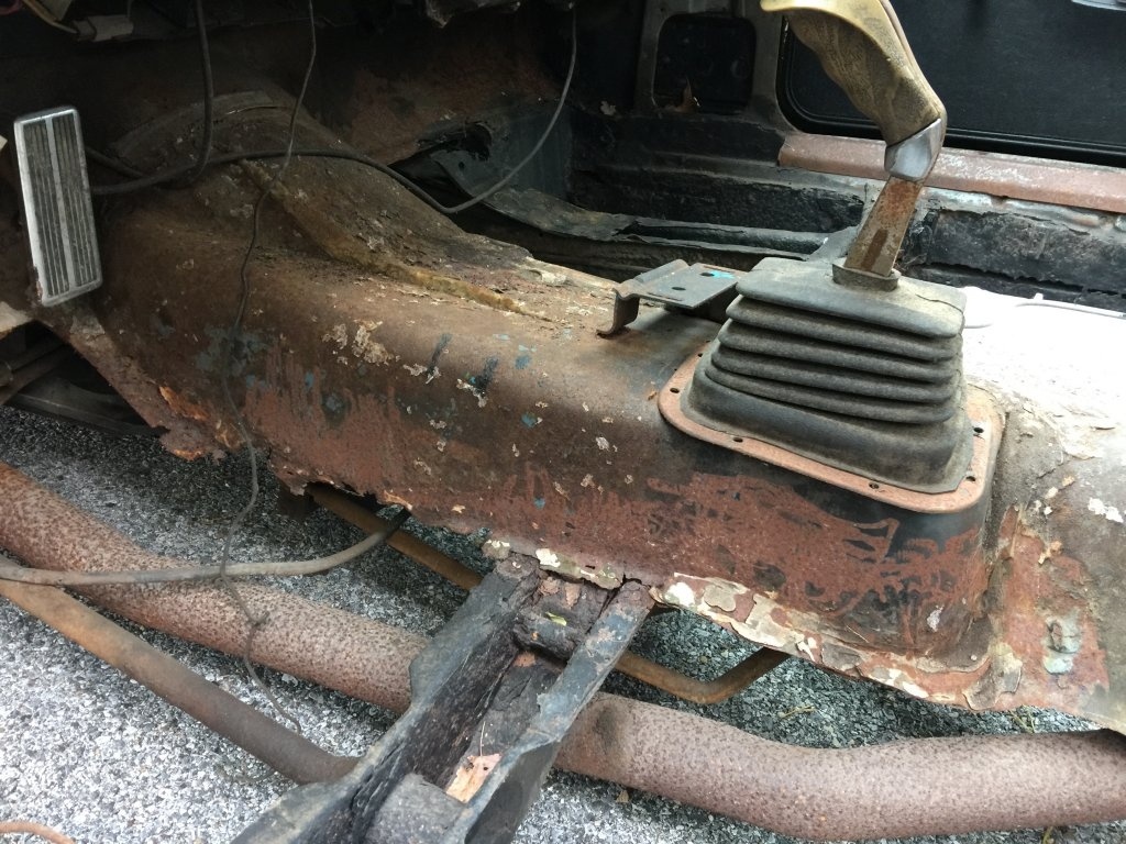

Thanks for everyones reply now it all makes more sense. Thanks 69rag500 for the pics. Here is a pic of. it's not a good pic but all i have right now
all that is left is the hump and crossmember
the floor is gone
get a new floor pan and slap the hump onto it
the floors are all the same for those cars
if you look underneath your hump, you will probably be able to see how the floor was cut out for the hump.
your hump looks like a bucket seat one.
you are better off with a full front pan with that much material gone
a Fred Flintstone edition floor,it must be a rust belt mopar..lol
Yes it is a bucket seat car. The floors were already cut out when I got it. I will definitely be getting the full floor and the Hump. There are a few other things I must do before the floor can go down. I will be reaching out to FBBO along the way. I have to change the torsion bar crossmember and need to figure out what to do with the inner rocker panels.
