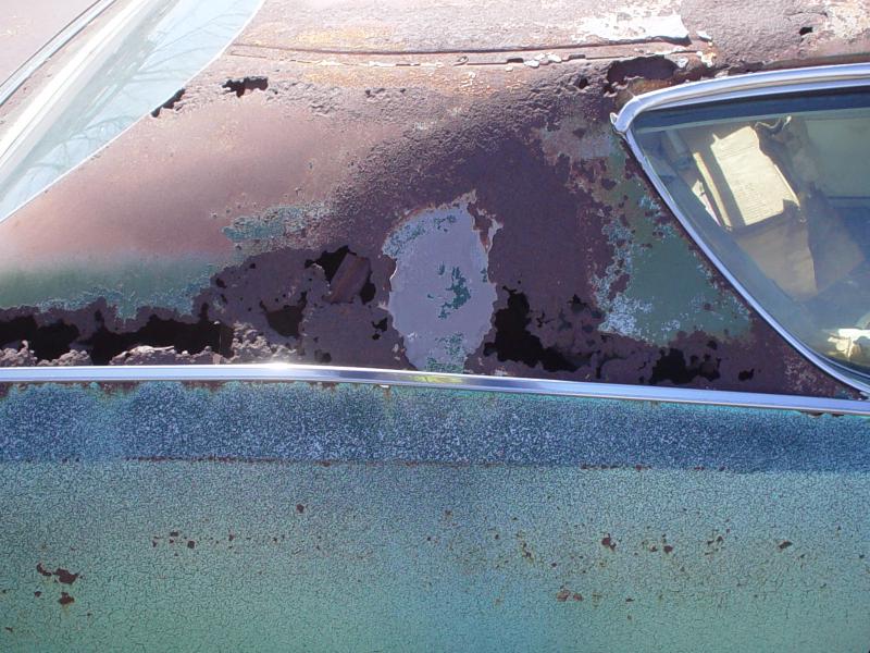

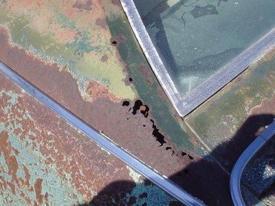

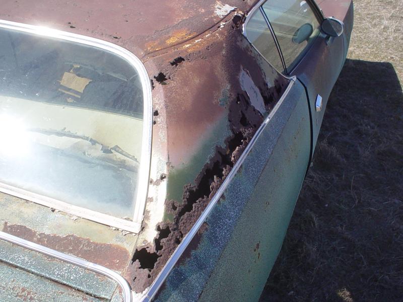

Took some pics of the damage. Passenger side got a brunt of the damage, and it was a little more involved than last time I looked. DSC01826.jpgDSC01824.jpgDSC01825.jpg
Hope these are good enough, the rail that holds the vinyl roof trim on the passenger side is gone and the chrome is kind of hanging in limbo.
Been looking on AMD's site, not seeing a panel for above and below the rear window. Do they or like goodmark make one for that area?
Al most all of the rust shown in those pics is on the quarter panels.
You can clearly see the seam between the quarters and the roof in those pics.
Roof might be able to be fixed, but I'd media blast it to see how thin it is.
Full quarters will take care of the rest.
Your "dutchman" panel even looks good.
I'm gonna say from my experience yes full 1/4s will be needed but not new your gonna need used ones from diner car there is gonna be rot under the chrome around window and also down inside on the iner outer wheel houses then there is trunk floor trunk drop offs so on and oh yea rockers the roof is probably pretty thin throughout most of it looks like my blue 73 when I took roof off then a but of light sanding it blew through in many more spots as far as the Dutchman panel it might be ok but you will most likely be doing a ton of work on it to repair the rust it will have (hidden)
I agree, full quarters should have you mostly covered. From what I can see of the roof you could do your own patches if it's not too bad. As was already said, make sure you treat and seal it VERY well if you don't go with a complete donor roofskin. I'd recommend Chassis Saver, really nasty stuff and from what experience I've had with it so far it seals really well. Just don't get it on your hands lol
But with rot like that I strongly suggest you take a real good look at the rest of the car (rockers, frame rails, valances, door posts, wheelhouses) so you really know how much work it's gonna be.
