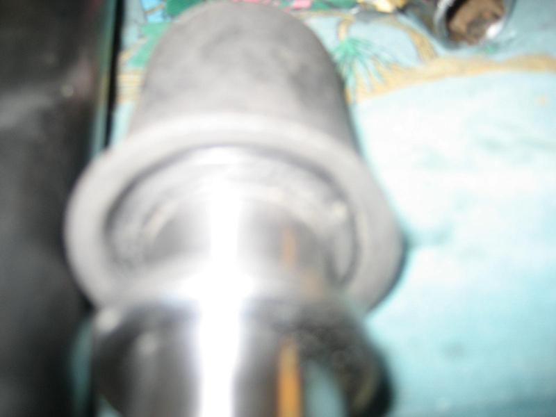

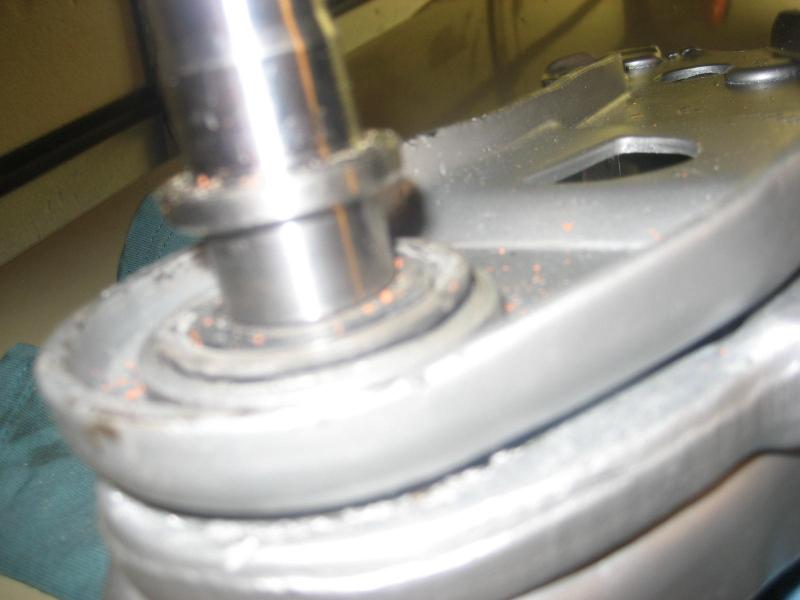

007.jpg009.jpgYou can torque the steering arm nut. Don't forget to put new bushing on pivot shaft then press into LCA. I found out hard way. Mancini Racing sells a kit to remove the shell. Then you can use your press against the allen head screw to push out shell. That's how I did it
I was able to press out the shafts with my shop press. Inner sleeve came out with the shaft. I welded a washer to the outer sleeve and used a bolt to press that out.
