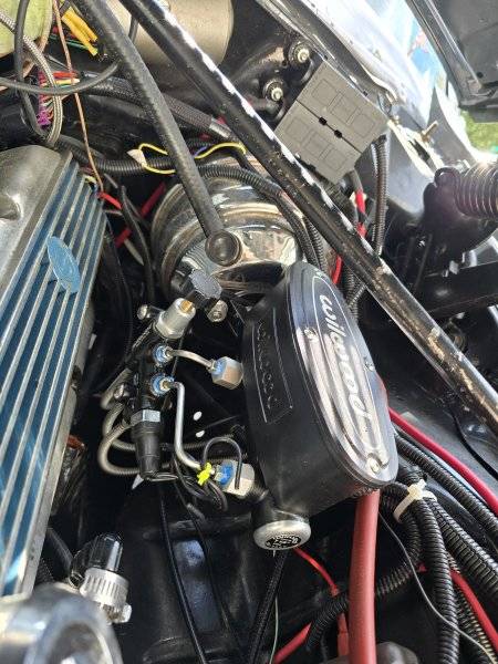

Hello,
I have a 74 Charger with a new Booster, Wilwood Master and proportioning valve, all new copper nickle lines, new hoses, calipers, rotors, and pads. Brakes suck, i can bleed them, pump them etc they get a little hard, but once you start the car it goes to the bottom.
The Master and proportioning valve where under warranty so i swapped them out with a second set. Checked all the fittings for leaks, none found. I bled them by attaching a clear hose to the passenger rear bleeder valve and the other end to the reservoir and pumped the brakes through 20' of hose until i saw no air. Did the same for the other 3 sides in order. The booster vac line is connected to the back of a Sniper 2 EFI system.
Any suggestions as to what i can try? Will extending the push rod (As posted on other threads) help? Currently my brake pedal is about a 1/2 inch above my gas pedal...

Brakes Suck = when bleed them, they get somewhat hard, when you drive it around the block the brakes get worst and sometimes bottoms out and you have to pump them a ton of times to get some braking back.
Brake Bleeding = Yes two people, pump the brakes until nothing but fluid is inside the 20' line which empties into the reservoir, when done we close the bleeder valve. Then for kicks we do it the old way, pump them until hard, open valve, when it starts to go down, close valve.
Brake rod = I was thinking of trying that. Stick a screwdriver into the Master to push the piston all the way down, then see if i can get my caliper in there to measure the depth. Then push the pedal down and measure the booster rod to see if it's going in enough.

Yes i did with the original, which i though might be the issue, every 5 pumps or so i would get a bubble of air from the rear reservoir, i was iffy on it so i got a new replacement, bench bled until no bubbles.
That system is sucking air in from someplace OR you are not getting all the air out, however given your bleeding efforts I would say that you are getting the air out, so that leaves air getting in.
Point here is that if you bleed it and you have pedal BUT you lose the pedal then air is either in the system (we are saying it isn't) or it is getting air in. If you don't have any leaks visible, its possible the back of the MC is leaking into the booster.
