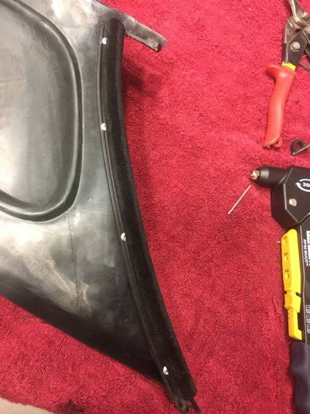

I'm wondering if anyone knows who sells the whiskers for the sail panels? I bought a kit awhile ago and the whiskers in that kit doesn't work on the sail panels, there's no clips.

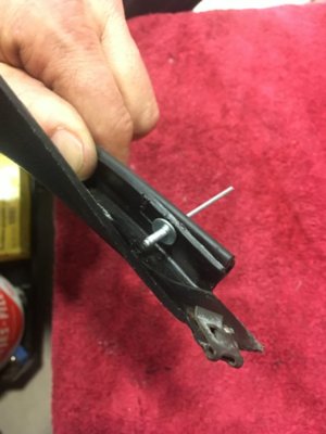

As you have plastic sail panels I assume it’s a SE, I don’t think there are any repro whiskers for those. I just drilled 4 holes and riveted with small washers.
It's a superbee. You fastener the whiskers with screws?
I bought a Top Cat kit, with that came several screws, staples and other but nothing I could use on the sail panel.
Screws I used on the doors, rivets on sail panel.
You are correct in that the outer door felts attach with the screws, and the inner quarter felts attach with the staples. Some people had rather use small screws or rivets in place of the staples.
I'll try that thanks alot
This is btw how how I did it.
FC52E9B1-0328-409C-8E34-81281F3B833B.jpeg 72ACB3C6-C06B-41A8-996A-373169D2F7AA.jpeg
Hmm does something cover the rivets? Visible from the inside?
