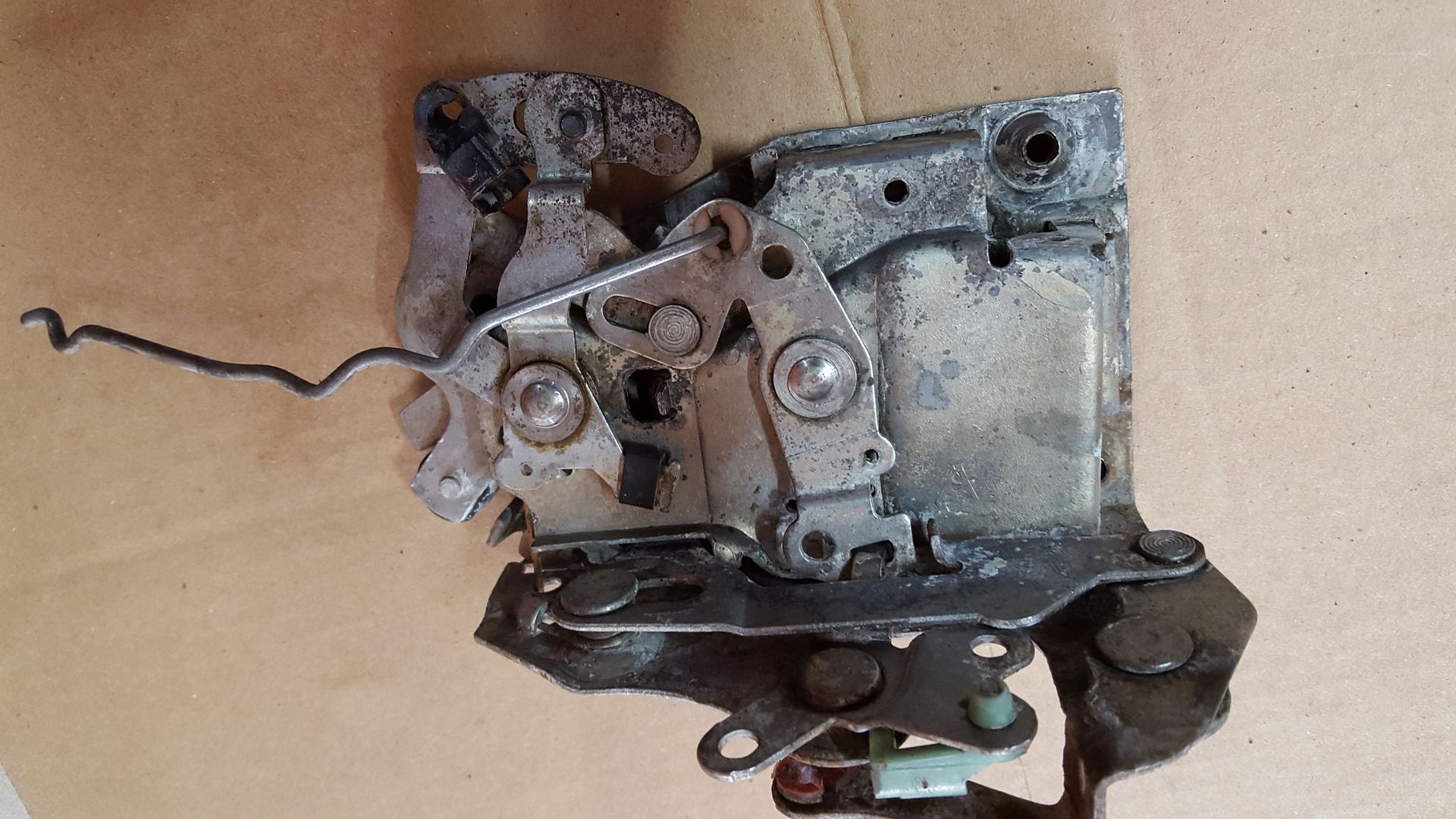

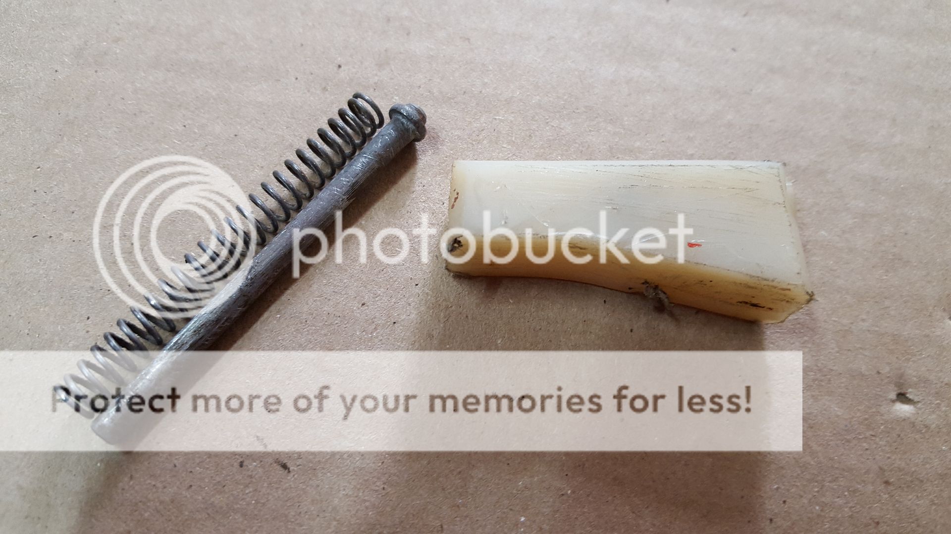

Im taking my latch out today. I think some rivets were stretched and warped, so the lever has way to much play. Maybe I'll be able to save it. are any of the internal components, like that plastic bar, reproduced?
This is my latch. Cleaned it up. The plastic block was flipped and kinked, not sure how it is supposed to be positioned originally. The body of the latch has some damage, around the striker opening. One of the rivets feels loose.
Is this a throw away or rebuild-able?
which side latch is it?
i have a good extra pass side one around somewhere
you see them pop up on ebay every so often..
Its the driver side. I think I found a replacement already though. Would like to resell mine if it's rebuildable
