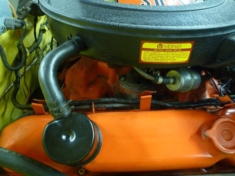

Whom I got mine from as well for my '70 Heat Stove, but the OP is saying "Breather" hose. '71 aircleaner has the breather hose wrapping around it..

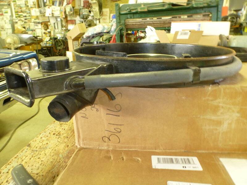

I bought the correct ribbed hose by the foot for my Bee, I believe from National Moparts here in Ontario, but I can't find it currently listed on their website. If I find time tomorrow I'll look through all my parts invoices for the source...

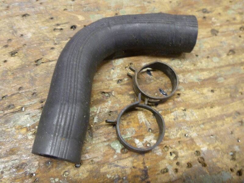

Here's a close up of my OE factory hose on the '70 that I got from MoparJohn.. I'll check it's diameter too.

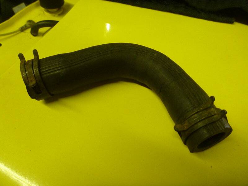

Measured my '69 Ramcharger, '70 dual and '71 dual. All 5/8" ID. @pjm8047 will have to get you a picture of the ribbing on the '71 hose Richard, as mine was replaced with heater hose about April 1990.

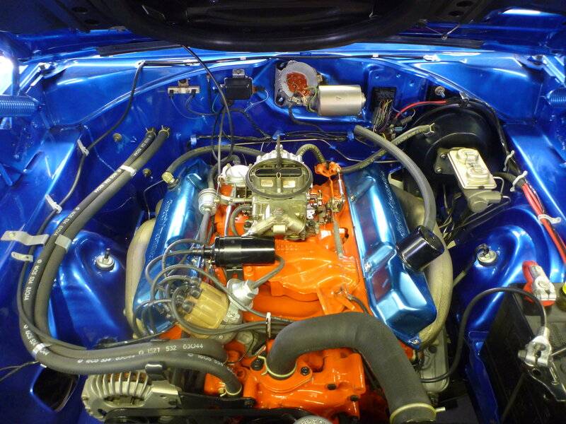

Did the PCV hose also have similar clamps, or no clamps? What about the brake booster hose, wire/ring clamps as shown in the picture?
