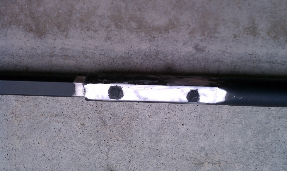

So, you may have done what I did when I rebuilt my 73 column, and that is break the shear pins off, they are plastic, and designed to break in the event of an accident. So if you found something that looks like these,
then that is what happened.
I just realigned my column, and used a liquid plastic, and filled it back in like this.
I have not had any issues with it.
Not sure about drilling and using aluminum pins or something like that, as the plastic actually surrounds the inner part of the steering shaft, it doesn't go through it like a pin.
